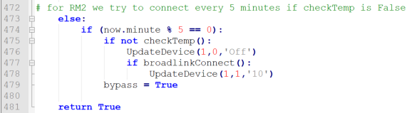

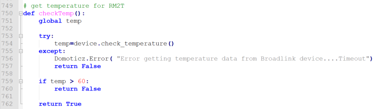

Check Temp
Update to Version: 4.10329
no more issue
Since few days I am facing these errors:
2019-01-07 08:55:20.789 Error: (RMPRO) Error Connecting to Broadlink device....192.168.1.26
2019-01-07 08:56:09.975 Error: (RMPRO) Error getting temperature data from Broadlink device....Timeout
2019-01-07 08:56:19.987 Error: (RMPRO) Error Connecting to Broadlink device....192.168.1.26
2019-01-07 09:00:19.962 Error: (RMPRO) 'onHeartbeat' failed 'TypeError':'unorderable types: NoneType() > int()'.
2019-01-07 09:00:19.962 Error: (RMPRO) ----> Line 475 in '/domoticz/plugins/BroadlinkRM2/plugin.py', function onHeartbeat
2019-01-07 09:00:19.963 Error: (RMPRO) ----> Line 759 in '/domoticz/plugins/BroadlinkRM2/plugin.py', function checkTemp
My RM is set as "Remote Control RM2/RM mini3" value="RM2",
it should not check temp Thanks

Re: Check Temp
I would say on the previous beta,
but even after the update, i still face issues:
2019-01-07 11:20:23.396 Error: (RMPRO) 'onHeartbeat' failed 'TypeError':'unorderable types: NoneType() > int()'.
2019-01-07 11:20:23.396 Error: (RMPRO) ----> Line 475 in '/domoticz/plugins/BroadlinkRM2/plugin.py', function onHeartbeat
2019-01-07 11:20:23.396 Error: (RMPRO) ----> Line 759 in '/domoticz/plugins/BroadlinkRM2/plugin.py', function checkTemp
2019-01-07 11:20:53.395 Error: (RMPRO) 'onHeartbeat' failed 'TypeError':'unorderable types: NoneType() > int()'.
2019-01-07 11:20:53.395 Error: (RMPRO) ----> Line 475 in '/domoticz/plugins/BroadlinkRM2/plugin.py', function onHeartbeat
2019-01-07 11:20:53.395 Error: (RMPRO) ----> Line 759 in '/domoticz/plugins/BroadlinkRM2/plugin.py', function checkTemp
2019-01-07 18:07:08.145 Error: (RMPRO) ini file not found: /domoticz/plugins/BroadlinkRM2/ini/BroadlinkRM2-3-254.ini
2019-01-07 18:07:11.752 Error: (RMPRO) ini file not found: /domoticz/plugins/BroadlinkRM2/ini/BroadlinkRM2-3-254.ini
2019-01-08 09:43:21.315 Error: (RMPRO) 'onCommand' failed 'NameError'.
2019-01-08 09:43:21.315 Error: (RMPRO) ----> Line 352 in '/domoticz/plugins/BroadlinkRM2/plugin.py', function onCommand
2019-01-08 09:43:21.315 Error: (RMPRO) ----> Line 937 in '/domoticz/plugins/BroadlinkRM2/plugin.py', function remoteSend
2019-01-08 09:43:29.376 Error: (RMPRO) ini file not found: /domoticz/plugins/BroadlinkRM2/ini/BroadlinkRM2-3-254.ini
2019-01-08 09:43:31.381 Error: (RMPRO) ini file not found: /domoticz/plugins/BroadlinkRM2/ini/BroadlinkRM2-3-254.ini Latest Beta on RPI3B+

Re: Check Temp
Do not see your plugin version, do not have enough information to provide help but...RueDesButtes wrote: Tuesday 08 January 2019 10:32Code: Select all
2019-01-07 11:20:23.396 Error: (RMPRO) 'onHeartbeat' failed 'TypeError':'unorderable types: NoneType() > int()'. 2019-01-07 11:20:23.396 Error: (RMPRO) ----> Line 475 in '/domoticz/plugins/BroadlinkRM2/plugin.py', function onHeartbeat 2019-01-07 11:20:23.396 Error: (RMPRO) ----> Line 759 in '/domoticz/plugins/BroadlinkRM2/plugin.py', function checkTemp 2019-01-07 11:20:53.395 Error: (RMPRO) 'onHeartbeat' failed 'TypeError':'unorderable types: NoneType() > int()'. 2019-01-07 11:20:53.395 Error: (RMPRO) ----> Line 475 in '/domoticz/plugins/BroadlinkRM2/plugin.py', function onHeartbeat 2019-01-07 11:20:53.395 Error: (RMPRO) ----> Line 759 in '/domoticz/plugins/BroadlinkRM2/plugin.py', function checkTemp 2019-01-07 18:07:08.145 Error: (RMPRO) ini file not found: /domoticz/plugins/BroadlinkRM2/ini/BroadlinkRM2-3-254.ini 2019-01-07 18:07:11.752 Error: (RMPRO) ini file not found: /domoticz/plugins/BroadlinkRM2/ini/BroadlinkRM2-3-254.ini 2019-01-08 09:43:21.315 Error: (RMPRO) 'onCommand' failed 'NameError'. 2019-01-08 09:43:21.315 Error: (RMPRO) ----> Line 352 in '/domoticz/plugins/BroadlinkRM2/plugin.py', function onCommand 2019-01-08 09:43:21.315 Error: (RMPRO) ----> Line 937 in '/domoticz/plugins/BroadlinkRM2/plugin.py', function remoteSend 2019-01-08 09:43:29.376 Error: (RMPRO) ini file not found: /domoticz/plugins/BroadlinkRM2/ini/BroadlinkRM2-3-254.ini 2019-01-08 09:43:31.381 Error: (RMPRO) ini file not found: /domoticz/plugins/BroadlinkRM2/ini/BroadlinkRM2-3-254.ini
For me, better to re-install the plugin (before made a copy of your ini files)
