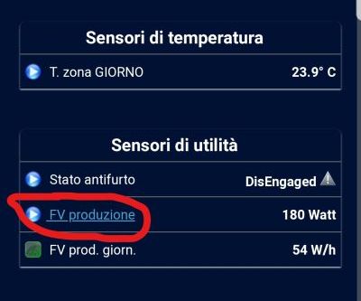

Small problem on mobile: one of the text descriptor is showed as a html link. Tried to rename, but it always is linked:

@fmal: if that's the mobile dashboard, then there's not much I can do. The mobile dashboard is generated by Domoticz. I guess it may be possible to hide the link visually through css. But it would still be a link.
