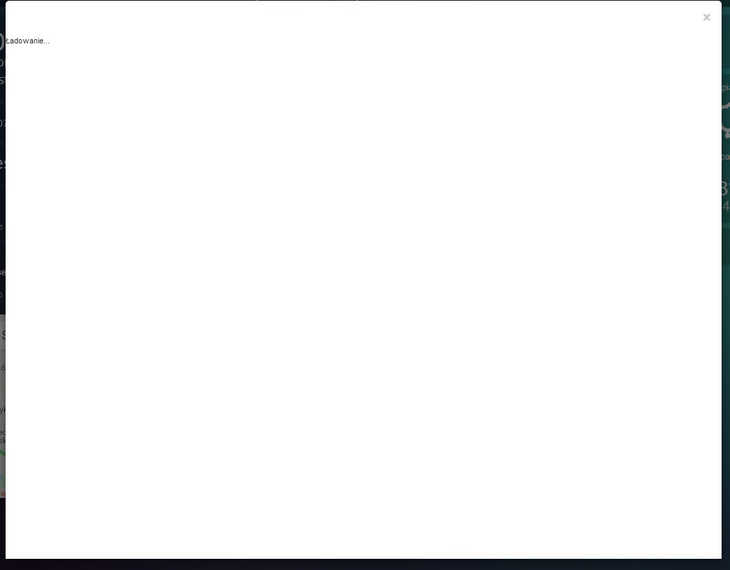

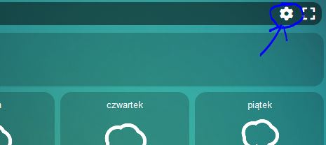

HI all,
i have 3 issues on Dashticz 3.1 stable.
Running on latest beta Domoticz on OrangePi2 Armbian latest.
I did re-install dashticz manually few times already. No luck.
1. Dashticz setting gear doesn't work for me. When I hit gear to see/update settings nothing happens. Literally nothing. No any pop up window. It was working in the past. I have set access level on chmod 777 for CONFIG.js file.
2. Option hide_data = true doesn't work for 2 custom sensors. Sensors show time to work using google maps script executed each weekday morning.
3. Is it possible to enlarge view from web cam? So far i have one webcam which works perfectly fine on Dashticz dashboard but when hit to enlarge (url: https://web.camIP:port/video) it says only Loading... It works when I use 'url: http://webcamIP:port/shot.jpeg but then i can only see last frame saved from the cam.
var config = {}
config['domoticz_ip'] = 'http://domoticz.ip';

HansieNL
Posts: 990
Post by HansieNL »
1. Do you run your own website with php? See: https://github.com/Dashticz/dashticz/b ... reparation
2. What kind of block are you using? Device, text or other.
3. Looks you need RTSP and not HTTP(S) for streaming video.
Blah blah blah

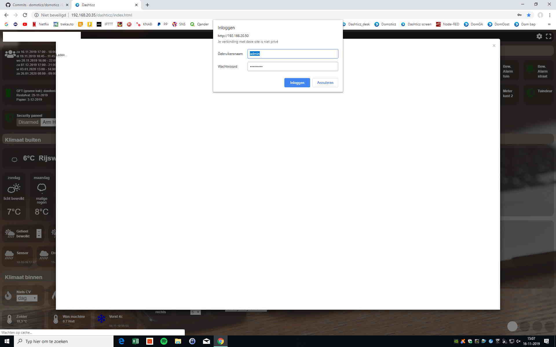

need some help with cam auth
Post by pvklink »
HI,
I have my dashboard all finished. But one thing is a pain in the ...
When i start my dashboard i have to manually login to my 2 cams,
Xiaomi Xiaofang 1S
and a dahua
This is my entry for the xiamoi (also tried username etc etc.)
https://192.168.20.52/cgi-bin/currentpi ... xx&pwd=xxx
is it possible to write a script for this so that i dont have to logon?
