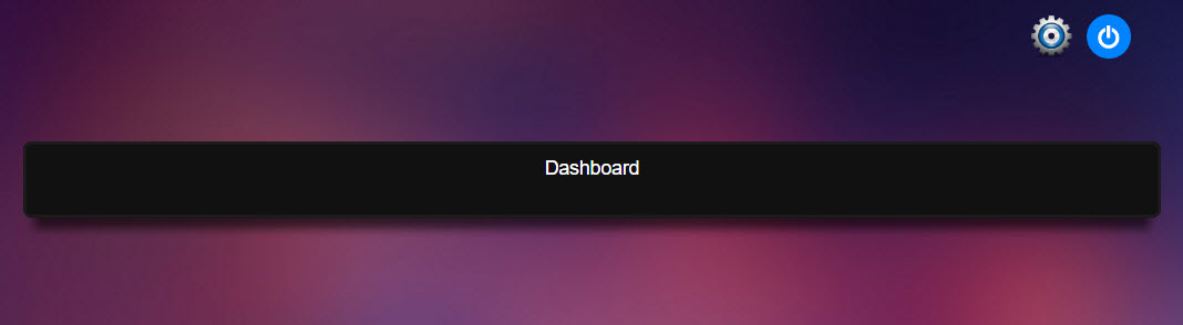

Hi, recently I don't see anything
2016-12-13 18-12-55.jpg (21.25 KiB) Viewed 4823 times
the same after update do v.3.5877
Error: PROXY: StartThread(): Exception: resolve: Host not found (authoritative) in logs every time after domoticz reboot
API key in place, MyDomoticz enable and Apps Allowed disabled in settings
browser cache cleared
thanks in advance for help

If you get that message in your logs, then probably you are using the latest stable version of Domoticz.
In order to use MyDomoticz you need to switch to beta channel updates.
Or just be patient for the new stable release.

Ok, thanks
