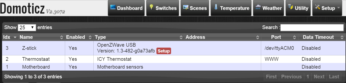

Posted: Sunday 20 September 2015 20:51
by timovd
Hello fellow-Dutchies (and others). The complete package is great indeed.
I have a Gen5 Z-stick and I have a Fibaro Dimmer 2. I have a DS412+ and my UPS is installed in the front-USB.
Does it matter what port you use? In the back of my DiskStation, there are two USB-3.0 ports.
I tried to add the stick...
...but when I click on include node under the Z-stick setup, I can't find the Fibaro Dimmer 2. On the dimmer I clicked three times on the "B-button", to put the dimmer in learning mode.
Is the stick connected well to the Synology? And am I doing the right procedure to add the dimmer?

timovd wrote: Is the stick connected well to the Synology? And am I doing the right procedure to add the dimmer?
You have to choose another serial port (Setup - Hardware - Select the Zwave controller and then below you can change the serial port).
The Setup button is blue when the right serial port is choosen. Your's is red now.

Posted: Monday 21 September 2015 18:34
by timovd
Thanks for your help! I cannot select a serial port; the drop-down is empty.
Edit: sorry! when using the USB 2.0 in the front a serial port can be connected. Only thing is that the UPS cannot be connected.

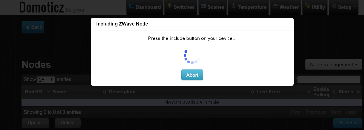

Now, when I click on "include node" I get the following pop-up.
On the FIbaro Dimmer 2, I press the B-button three times to put it in learning mode, but nothing is happening. There is about 2 meter distance between the Z-stick and the Dimmer. Am I still doing something wrong?
