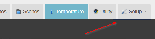

Re: Aurora theme
When having the menu at the top the option to choose rooms is hidden.

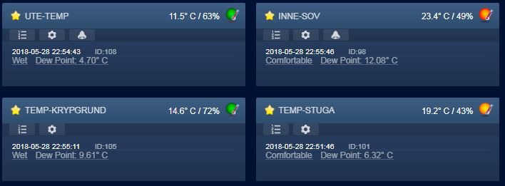

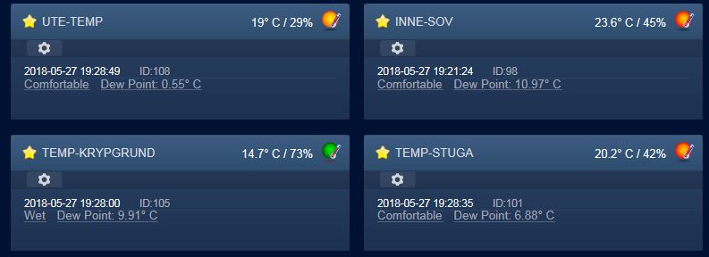

Re: Aurora theme
Hm. temperature log and notifications buttons missing
- Posts: 331
- Joined: Wednesday 21 December 2016 9:11
- Domoticz version: current
Re: Aurora theme
@quack3D: ah yes, that color cannot be changed via the interface. But you can add your own CSS to do that. I was hoping people would share CSS for such small things.
@rednas:
- Yes, the clock is different. You cannot move it.
- The block shadow is replaced by a red line in your case. It cannot show both the shadow and the line.
- Grouping should work. Try using letters (a b c) instead of a number.
- The theme does not use a versioning system. You are expected to always update to the latest version, as there is no risk involved in updating. It's all just styling.
I have fixed the missing buttons on the temperature page.

Re: Aurora theme
@quack3D: could you try adding this custom CSS:
body:not(.login) #holder .container-fluid {padding-top:50px}
Re: Aurora theme
Yeah, exactly. I was hoping someone would share a nice complete CSS that "worked together" with all other colors.blauwebuis wrote: ↑Monday 28 May 2018 14:04 @quack3D: ah yes, that color cannot be changed via the interface. But you can add your own CSS to do that. I was hoping people would share CSS for such small things.
It works but it also pushes the Manual Light/Switch and Learn Light/Switch in Switches down below it. Same on the Temperature tab. I would say the Room selector should be at the same height as those buttons, not above them.blauwebuis wrote: ↑Monday 28 May 2018 14:13 @quack3D: could you try adding this custom CSS:

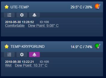

- Posts: 107
- Joined: Tuesday 31 January 2017 21:54
Re: Aurora theme
@rednas: You can only merge simple items. Or try adding one switch to the mix.
[/quote]
What do you mean exactly with simple items? Adding a switch to the mix doesn't work, as it places the switch at a different column.
[/quote]
only items with one icon works in groups for example
@blauwebuis
Almost there. temp log seem ok now
Notifications still need a touch. Seem like items with a notification already set don't show the icon (colored version).
[/quote]
[/quote]
@blauwebuis
Re: Aurora theme
hello, found and fixed bug... (hope that fix is safe for rest theme
also
should be in git by default...
.btn-small.btn-default {
padding: 0;

Re: Aurora theme
@devros: I've added the horizontal menu fix.
I'm not sure how the other CSS lead to the fix of the buttons ow fitting in the item. The item seams wider, while the fix implies that the buttons become narrower.
I've also added a fix for the missing option buttons.
