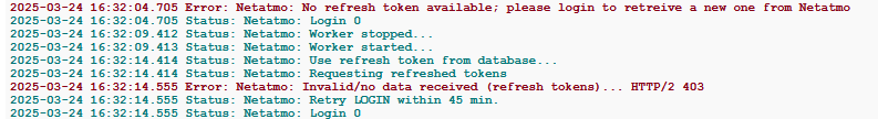

You have another error than most of us here have. We have:jcb2 wrote: Monday 24 March 2025 12:01 always one other error : "No access granted, forcing login again (Refresh tokens): invalid_client"
Invalid/no data received (refresh tokens)... HTTP/2 403
You should check your client ID, Client secret and tick the scope(s) you own in Domoticz.

With last beta, after one renew of ID and password and one restart I have always one error :
2025-03-24 17:52:28.197 Status: Domoticz V2025.1 (build 16586) (c)2012-2025 GizMoCuz
2025-03-24 17:52:37.668 Error: Météo: Invalid/no data received (refresh tokens)... HTTP/2 403
When I try to use the button connexion into hardware I have this error :

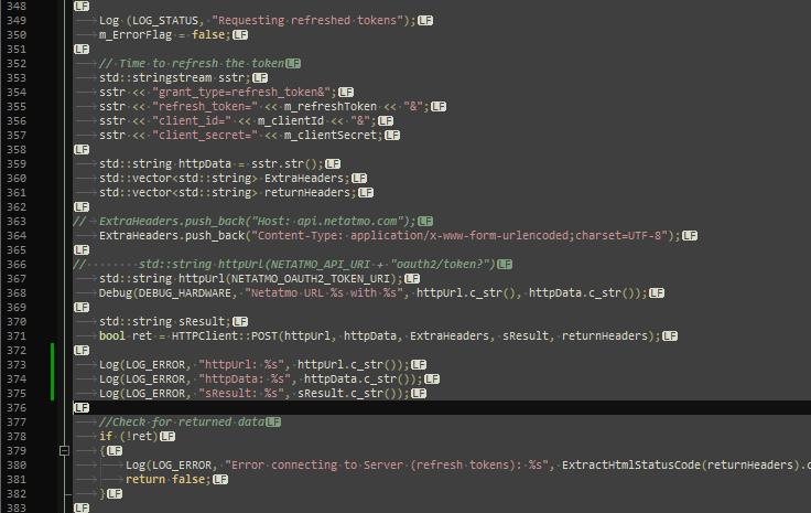

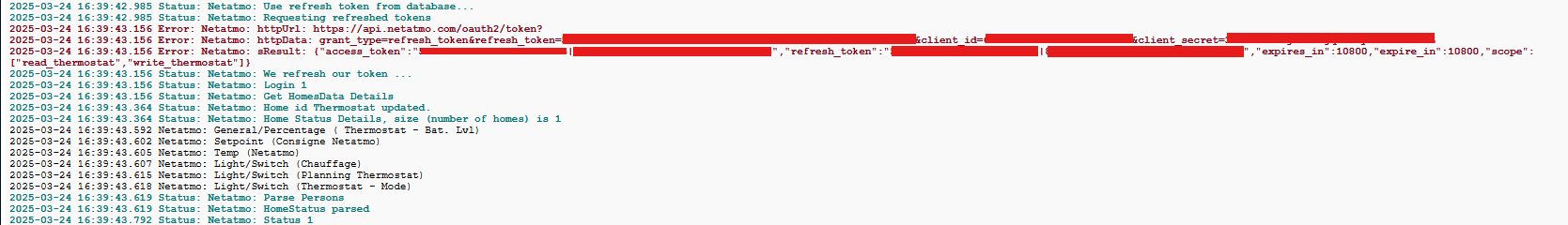

Added some debug lines to the source:
compile and restart:
Got a good reply from the Netatmo server then, it worked directly, no relation with my changes in the source.
Still working randomly, I'm saved probably until the next restart.
Debug(DEBUG_HARDWARE, "Netatmo URL %s with %s", httpUrl.c_str(), httpData.c_str());Code: Select all
ExecStart=/domoticz/domoticz -www 8080 -sslwww 443 -log "/var/log/domoticz-1.log" -loglevel all -debuglevel normal,hardware
# ExecStart=/domoticz/domoticz -www 8080 -sslwww 443 -log "/var/log/domoticz-1.log" -loglevel allkind regards

jcb2
- Posts: 44
- Joined: Wednesday 04 January 2023 7:30
- Location: Belgium
Re: Netatmo authentication changes Oct 2022
Yes it is with version 16586.
But the connection up durring the night and is down this morning.
Very strange. Below I provide the log about this error and hope it is an help.
Thanks,
Jean-Charles
Log this night and morning :
2025-03-26 02:29:31.744 Status: Météo: Use refresh token from database...
2025-03-26 02:29:31.744 Status: Météo: Requesting refreshed tokens
2025-03-26 02:29:31.928 Status: Météo: Retry LOGIN within 45 min.
2025-03-26 02:29:31.928 Status: Météo: Login 0
2025-03-26 03:14:32.306 Status: Météo: Use refresh token from database...
2025-03-26 03:14:32.306 Status: Météo: Requesting refreshed tokens
2025-03-26 03:14:32.505 Status: Météo: Retry LOGIN within 45 min.
2025-03-26 03:14:32.505 Status: Météo: Login 0
2025-03-26 03:59:32.876 Status: Météo: Use refresh token from database...
2025-03-26 03:59:32.876 Status: Météo: Requesting refreshed tokens
2025-03-26 03:59:33.052 Status: Météo: Retry LOGIN within 45 min.
2025-03-26 03:59:33.052 Status: Météo: Login 0
2025-03-26 04:44:33.447 Status: Météo: Use refresh token from database...
2025-03-26 04:44:33.447 Status: Météo: Requesting refreshed tokens
2025-03-26 04:44:33.606 Status: Météo: Retry LOGIN within 45 min.
2025-03-26 04:44:33.607 Status: Météo: Login 0
2025-03-26 05:29:34.000 Status: Météo: Use refresh token from database...
2025-03-26 05:29:34.000 Status: Météo: Requesting refreshed tokens
2025-03-26 05:29:34.174 Status: Météo: Retry LOGIN within 45 min.
2025-03-26 05:29:34.175 Status: Météo: Login 0
2025-03-26 06:14:34.546 Status: Météo: Use refresh token from database...
2025-03-26 06:14:34.546 Status: Météo: Requesting refreshed tokens
2025-03-26 06:14:34.712 Status: Météo: Retry LOGIN within 45 min.
2025-03-26 06:14:34.712 Status: Météo: Login 0
2025-03-26 06:59:35.079 Status: Météo: Use refresh token from database...
2025-03-26 06:59:35.079 Status: Météo: Requesting refreshed tokens
2025-03-26 06:59:35.252 Error: Météo: Invalid/no data received (refresh tokens)... HTTP/2 403
2025-03-26 06:59:35.252 Status: Météo: Retry LOGIN within 45 min.
2025-03-26 06:59:35.252 Status: Météo: Login 0
2025-03-26 07:44:35.614 Status: Météo: Use refresh token from database...
2025-03-26 07:44:35.614 Status: Météo: Requesting refreshed tokens
2025-03-26 07:44:35.786 Error: Météo: Invalid/no data received (refresh tokens)... HTTP/2 403
2025-03-26 07:44:35.786 Status: Météo: Retry LOGIN within 45 min.
2025-03-26 07:44:35.786 Status: Météo: Login 0
2025-03-26 07:46:45.118 Status: Météo: Worker stopped...
Into debug mode I have these informations :
Error :
2025-03-26 08:16:46.736 [7fd1ce7fc6c0] Error: Météo: Invalid/no data received (refresh tokens)... HTTP/2 403
Log info :
2025-03-26 08:16:46.568 [7fd1ce7fc6c0] Debug: Météo: Netatmo URL https://api.netatmo.com/oauth2/token? with grant_type=refresh_token&refresh_token=5f4d36d****************&client_id=67e2ee72e3***********&client_secret=CVGzSpWbyw*********************
2025-03-26 08:16:46.730 [7fd1ce7fc6c0] Debug: Météo: Netatmo Invalid ... <!DOCTYPE html PUBLIC '-//W3C//DTD XHTML 1.0 Transitional//EN' 'http://www.w3.org/TR/xhtml1/DTD/xhtml1-transitional.dtd'>

homeJLB
- Posts: 154
- Joined: Tuesday 16 October 2018 23:01
- Domoticz version: 2024.7
- Location: Belgium
My test system did also have a block after the 20 min wait.

2025-03-25 19:38:10.509 Error: Netatmo: Invalid/no data received (refresh tokens)... HTTP/2 403
2025-03-25 19:38:10.513 Status: Netatmo: Retry LOGIN within 45 min.
2025-03-25 19:38:10.513 Debug: Netatmo: Refresh Token Flag 1 ...
2025-03-25 19:38:10.513 Status: Netatmo: Login 0
