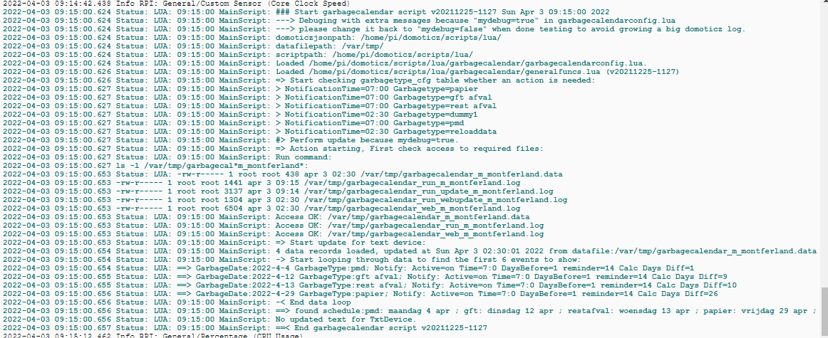

module m_montferland
I have a issue with the list garbage. If there are two of the same type of garbage plannend in the list (I use 4) only one showed up.
I tried several times debug also cleared every time cache but no result.
Example
GFT: 1 apr
PMD: 5 apr
Rest: 15 apr
(GFT: 18 apr) doesn't show
Papier: 30 apr
If there is a GFT on 18 apr, this is not in the list, but afther 1 apr it shows up
the list is as follow
PMD: 5 apr
Rest: 15 apr
GFT: 18 apr
Papier: 30 apr
jvdz
Posts: 2332
Domoticz version: 4.107
Re: GarbageCalendar (new version) lua scripts
Post by jvdz »
What is the setting for this config variable?
ShowSinglePerType = false
Guess you set that to true which means only the first next date per garbage type is shown.
gvandick
Posts: 37
Joined: Saturday 01 July 2017 12:48
Post by gvandick »
No the setting is : false
ShowNextEvents = 4
Combine_Garbage_perDay = false
I have change this to try but no effect. I try several combinations for these settings.
Also I change ShowNextEvents to 6 but also no effect still 4 events show up in domoticz dummy, but in the domoticz log shows searching for 6
I check every changing In the domoticz log. still the same 4 items, missing the second date for GFT
Schermafbeelding 2022-04-03 091820.png (139.5 KiB) Viewed 2228 times
jvdz
Posts: 2332
Post by jvdz »
I've just tested with an test address I have for the m_montferland module and it simply returns the next 4 dates, one for each garbage type, so guess that is the way it works for montferland:
=== garbagecalendar_m_montferland.data ====================================================================
-- Table: {1}
   {2},
   {3},
   {4},
   {5},
   ["Garbage_LastUpdate"]="04/03/22 10:44:02",
-- Table: {2}
   ["garbagedate"]="2022-4-4",
   ["garbagetype"]="GFT afval",
-- Table: {3}
   ["garbagedate"]="2022-4-6",
   ["garbagetype"]="PMD",
-- Table: {4}
   ["garbagedate"]="2022-4-9",
   ["garbagetype"]="Papier",
-- Table: {5}
   ["garbagedate"]="2022-4-25",
   ["garbagetype"]="Rest afval",
jvdz
Posts: 2332
Post by jvdz »
With some trial and error I figured out how to get all dates till the end of the year. In November/December it will retrieve also the next year data as it was doing already before:
Schedule: maa 4 apr: gft afval ; woe 6 apr: pmd ; zat 9 apr: Blauwe bak ; zat 16 apr: gft afval ;
The change is available in github, please give it a try and see if it also works for you. :)
