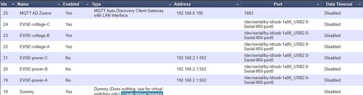

I fear I'm also looking for an alternative if indeed this code is no longer maintained (unfortunately!!)
Have done a number of updates on my Domoticz RPI system lately. Most recent was the move Domoticz 2022.1 -> 2023.1 (still on Buster).
Now, errors show up more of less randomly on Modbus which is used to read 8 values from an energy meter. Here is an example of an error message. Similar error logging seemingly randomly on the other Reads. Most of the times a Read works ok:
2023-03-14 08:58:22.026 EVSE-power-A: Pushing 'onHeartbeatCallback' on to queue
2023-03-14 08:58:22.076 EVSE-power-A: Processing 'onHeartbeatCallback' message
2023-03-14 08:58:22.076 EVSE-power-A: Acquiring GIL for 'onHeartbeatCallback'
2023-03-14 08:58:22.076 EVSE-power-A: Calling message handler 'onHeartbeat' on 'module' type object.
2023-03-14 08:58:22.076 EVSE-power-A: onHeartbeat called
2023-03-14 08:58:22.077 EVSE-power-A: MODBUS DEBUG - INTERFACE: Port=/dev/serial/by-id/usb-1a86_USB2.0-Serial-if00-port0, BaudRate=9600, StopBits=1, ByteSize=8 Parity=E
2023-03-14 08:58:22.077 EVSE-power-A: MODBUS DEBUG - SETTINGS: Method=rtu, Device ID=13, Register=18, Function=4, Data type=float32, Pollrate=30
2023-03-14 08:58:24.085 EVSE-power-A: MODBUS DEBUG - RESPONSE: Modbus Error: [Input/Output] Modbus Error: [Invalid Message] No response received, expected at least 2 bytes (0 received)
2023-03-14 08:58:24.086 Error: EVSE-power-A: Modbus error decoding or received no data (RTU/ASCII/RTU over TCP)!, check your settings!
I'm using the 2021.7 versions for Modbus Read (and Write) and I have not upgraded pymodbus and pymodbusTCP in a while.

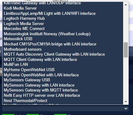

After I got modbus working again on Domoticz 2023.1 on Buster, today upgraded to Bullseye.
As already mentioned by andrehj Bullseye caused the modbus plugin to fails.
In my case, after the Bullseye update, the Modus 'hardware' was gone from Domoticz Setup/Hardware nd there is also not an option to reinstall it (see attached)
Is there a (simple) way to bring this modbus back to life again as far as someone knows?
Tip I got: follow this information first: https://www.domoticz.com/wiki/Using_Python_plugins
Any other suggestions welcome.

Update: following steps in https://www.domoticz.com/wiki/Using_Python_plugins resulted in checking the 'about' screen for Domoticz, which reported 'Python version: none' now changed to "Python Version: 3.9.2 (default, Mar 12 2021, 04:06:34) [GCC 10.2.1 20210110]".
After a restart, some other Python script (Nefit EMS from "BBQKees") started to work again.
Modbus still failing with similar errors in the log for each modbus device:
2023-03-20 09:59:54.320 Error: EVSE-power: Traceback (most recent call last):
2023-03-20 09:59:54.320 Error: EVSE-power: File "/home/pi/domoticz/plugins/modbus-read/plugin.py", line 175, in <module>
2023-03-20 09:59:54.320 Error: EVSE-power: import pymodbus
2023-03-20 09:59:54.320 Error: EVSE-power: ModuleNotFoundError: No module named 'pymodbus'
Moving to the next step!
Posts: 6682
Domoticz version: 2025.1
Re: Python plugin: Modbus RTU / ASCII / TCP/IP
Did you install the module with sudo? As this is a known solution for error
ModuleNotFoundError: No module named 'xxxxxx'
See also the wiki page Using Python Plugins.
