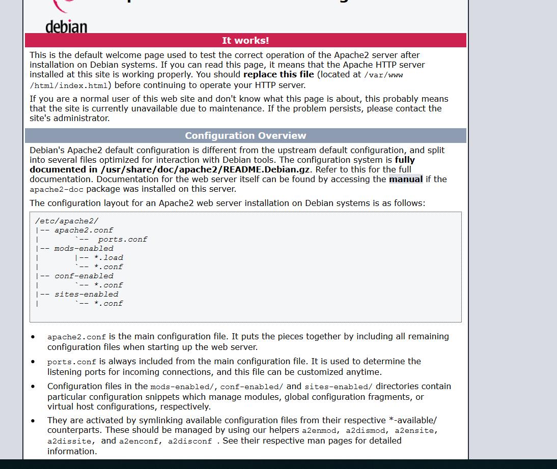

What's the IP-address of your RPi?
Check whether Apache is running by opening 'http://<IP of your RPi> in a web browser.
You should see the Apache demo page.
Re: Dashticz - Module - Calendar
Posted: Saturday 19 January 2019 22:17
by Derik
Running:
192.168.5.70
Posted: Saturday 19 January 2019 22:22
by Lokonli
Good.

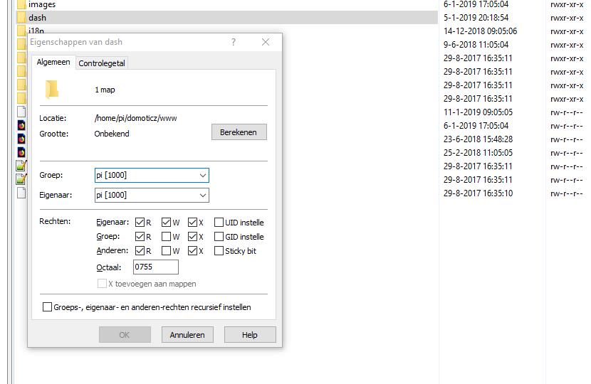

I guess the Apache php module is not installed. Try
sudo apt-get install libapache2-mod-php
sudo systemctl restart apache2
And after that probably you have to set the right permissions:
chmod -R a+rX /home/pi/dashticz_v2

Let's find out in PM what goes wrong, and we'll post the solution afterwards here and on the Wiki.

Looks he is working now..
Thanks to lokonli ;) ;)
