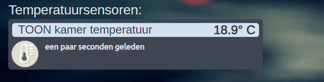

* temperature sensor: TOON kamer temperatuur

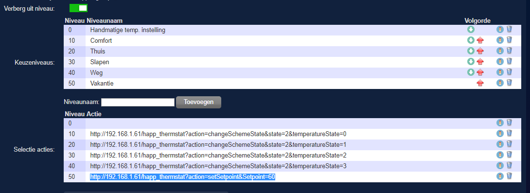

now we need to change te level names and level actions in the selector switches we just created.
Its important you call the level names exactly!:
* TOON scene
* level 0: Handmatige temp. instelling
* level 10: Comfort
* level 20: Thuis
* level 30: Slapen
* level 40: Weg
* level 50: Vakantie
* also activate: Verberg uit niveau!
level actions:
level 0: leave empty (its updating by the script when changing setpoint manualy!)
level 10: http://TOON_IP/happ_thermstat?action=changeSchemeState&state=2&temperatureState=0
level 20: http://TOON_IP/happ_thermstat?action=changeSchemeState&state=2&temperatureState=1
level 30: http://TOON_IP/happ_thermstat?action=changeSchemeState&state=2&temperatureState=2
level 40: http://TOON_IP/happ_thermstat?action=changeSchemeState&state=2&temperatureState=3
level 50: http://TOON_IP/happ_thermstat?action=setSetpoint&Setpoint=60

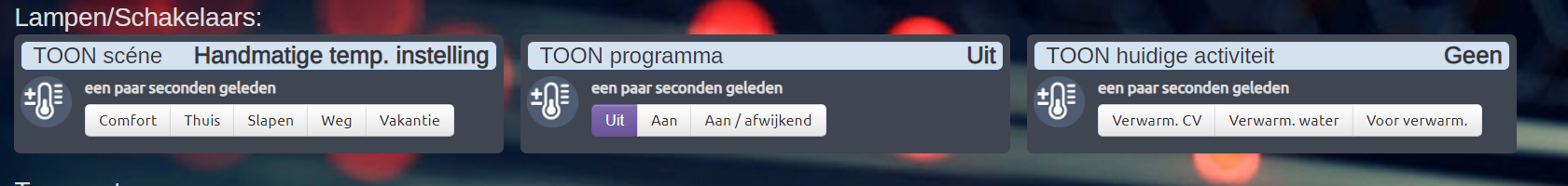

now it look like this:
TOON scene.PNG (50.23 KiB) Viewed 3103 times
now open the selector switch TOON programma:
level 0: Uit
level 10: Aan
level 20: Aan / afwijkend
level actions:
level 0: http://TOON_IP/happ_thermstat?action=changeSchemeState&state=0
level 10: http://TOON_IP/happ_thermstat?action=changeSchemeState&state=1
level 20: leave empty
should look like this:
TOON programma.PNG (25.7 KiB) Viewed 3103 times

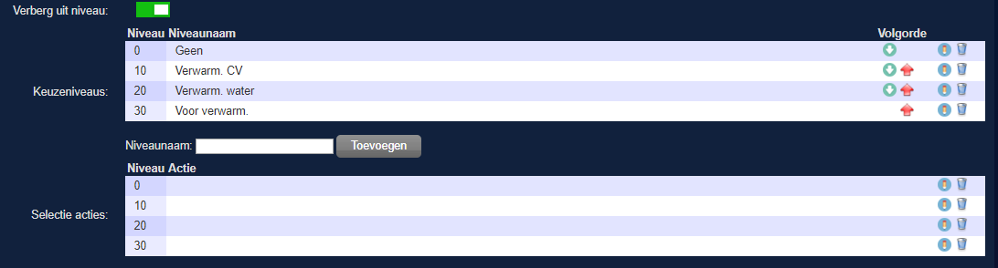

now the final selector switch TOON huidige activiteit:
heren we only have to change the level names:
* level 0: Geen
* level 10: Verwarm. CV
* level 20: Verwarm. water
* level 30: Voor verwarm.
* also activate Verberg uit niveau
TOON activiteit.PNG (25.1 KiB) Viewed 3103 times

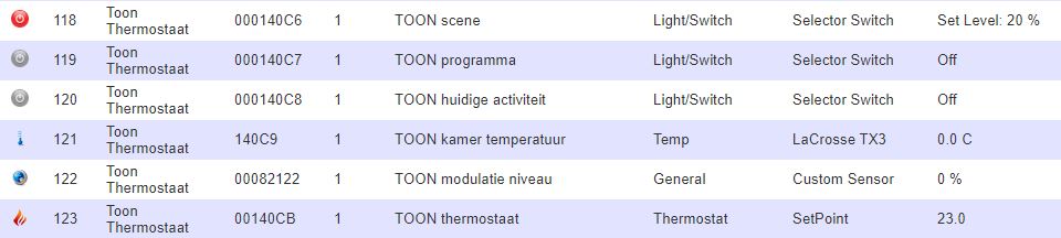

now you can go to youre devices menu en note the IDX numbers of the switches you just created, you need to set them in the in the script.

To update youre setpoint from Domoticz to TOON you need to use this LUA script! (NOT DzVents!)
its important you select Device at the trigger settings!
like this:
the script:
	ToonThermostatSensorName = uservariables['toon_thermostaat_naam'] -- Sensor showing current setpoint
	ToonIP = uservariables['toon_ip']
	for deviceName,deviceValue in pairs(devicechanged) do
	if (deviceName == ToonThermostatSensorName) then
	if uservariables['toon_thermostaat_helper'] == 1 then
	commandArray['Variable:toon_thermostaat_helper'] = '0'
	SetPoint = otherdevices_svalues[ToonThermostatSensorName]
	ToonCommand = string.format('http://%s/happ_thermstat?action=setSetpoint&Setpoint=%s', ToonIP, SetPoint*100)
	print('Setting Toon setpoint to '.. SetPoint)
	commandArray['OpenURL'] = ToonCommand
return commandArray
no changes or settings needed in this script!
I hope everything is working now!!

After trying the Dzvent script as explained in: https://ehoco.nl/geroote-toon-bedienen-met-domoticz/, Domoticz is verry slow and/or hangs.
So I tried the scripts from OedzesG.
Don't know what I did wrong but I get no Values.
Here what I did:
Created dummy devices
Changed the level names and level actions in the selector switches (called the level names exactly)
So far so Good :D
Using: Domoticz V4.10717, Raspberry 3B+, Z-wave plus, Wemos
George
Posts: 8
Joined: Saturday 16 June 2018 16:33
Domoticz version: V4.10717
Re: Controlling Toon [HACKED] from Domoticz
Post by George »
Search for Idx:
Then created Lua script (Copy past, just edit IP adres Toon and IDX)
also use this LUA script To update setpoint from Domoticz to TOON:
But finally I can not read/change values.... at least there is no change in domoticz.
What went wrong?
Is the first scrip LUA? (what I did) or is it dzVents?
George
Posts: 8
Post by George »
Update:
Created first script (Toon Script) as dzVents.
And las one - as mentioned - as LUA and set trigger as device.
Log file:
This works:
And this not:
No reaction when i change set point for temp.
No temp. reading.
:roll: Take some Beer for now.... maybe that helps :lol:
