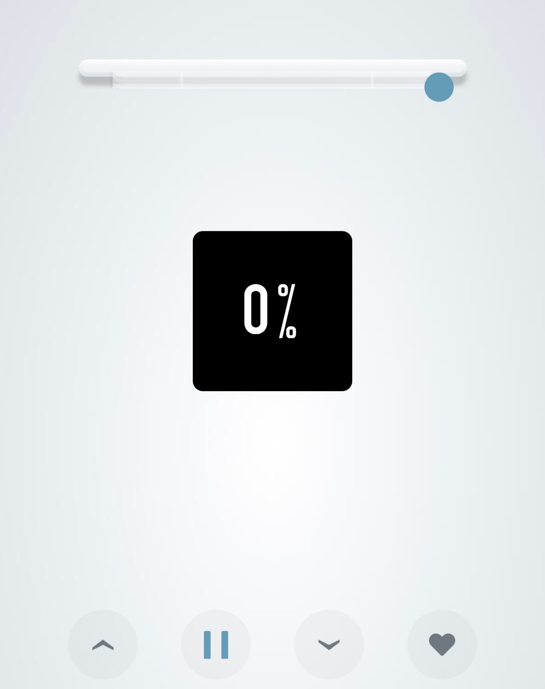

i'm really happy that the Curtain Switch is also working perfectly, it open and close the roller blind like it should..!
I have only one question, why is the stop (pause) button not working?
Is it possible to do also the roller blind open half (50%) for example?
It works only with full OPEN or full CLOSE (On / Off) but the stop (pause) button is doing nothing :(
Ofcourse in the Tuya app the Pause is working correctly..

The stop command was not programed jet in the plugin, i add it in the new version 1.0.11. I can't send percentage to the Tuya api, maybe you can make a time script to run 30 sec if 1 min is full open. 😅

Stop is still not working :cry:
I'm using it as venetian eu, or did i do something wrong?
How can i use the stop?

2021-07-10 09:37:46.443  Status: User: Admin initiated a switch command (2622/Rolgordijn Keuken/On)
2021-07-10 09:37:46.443  Tuya: (Tuya) Pushing 'onCommandCallback' on to queue
2021-07-10 09:37:46.476  (Tuya) Processing 'onCommandCallback' message
2021-07-10 09:37:46.476  Tuya: (Tuya) Calling message handler 'onCommand' on 'module' type object.
2021-07-10 09:37:46.476  Tuya: (Tuya) onCommand called for Unit 1: Parameter 'On', Level: 0
2021-07-10 09:37:46.477  Tuya: (Tuya) Sending command for DeviceID=00***
2021-07-10 09:37:50.710  Status: User: Admin initiated a switch command (2622/Rolgordijn Keuken/Stop)
2021-07-10 09:37:50.710  Tuya: (Tuya) Pushing 'onCommandCallback' on to queue
2021-07-10 09:37:50.727  (Tuya) Processing 'onCommandCallback' message
2021-07-10 09:37:50.727  Tuya: (Tuya) Calling message handler 'onCommand' on 'module' type object.
2021-07-10 09:37:50.727  Tuya: (Tuya) onCommand called for Unit 1: Parameter 'Stop', Level: 0
2021-07-10 09:37:50.727  Tuya: (Tuya) Sending command for DeviceID=00****
2021-07-10 09:37:52.030  Tuya: (Tuya) Pushing 'onHeartbeatCallback' on to queue
2021-07-10 09:37:52.080  (Tuya) Processing 'onHeartbeatCallback' message
2021-07-10 09:37:52.080  Tuya: (Tuya) Calling message handler 'onHeartbeat' on 'module' type object.
2021-07-10 09:37:52.080  Tuya: (Tuya) onHeartbeat called time=1625902672.0804992
2021-07-10 09:37:52.105  Status: User: Admin initiated a switch command (2622/Rolgordijn Keuken/Off)
2021-07-10 09:37:52.106  Tuya: (Tuya) Pushing 'onCommandCallback' on to queue
2021-07-10 09:37:52.130  (Tuya) Processing 'onCommandCallback' message
2021-07-10 09:37:52.130  Tuya: (Tuya) Calling message handler 'onCommand' on 'module' type object.
2021-07-10 09:37:52.130  Tuya: (Tuya) onCommand called for Unit 1: Parameter 'Off', Level: 0
2021-07-10 09:37:52.131  Tuya: (Tuya) Sending command for DeviceID=00***
2021-07-10 09:37:52.179  (Rolgordijn Keuken) Updating device from 1:'On' to have values 0:'Off'.
2021-07-10 09:37:52.192  Tuya: (Tuya) Update 0:'Off' (Rolgordijn Keuken) TimedOut=False
I did a close (on) then STOP (didnt work), then open (Off) again..
Damn... make a typo in de code used 'stop' instead of 'Stop'. update the plug-in again and test again.
Lol... Hold'on a couple minutes!
 remote: Enumerating objects: 3, done.
remote: Counting objects: 100% (3/3), done.
remote: Compressing objects: 100% (3/3), done.
remote: Total 3 (delta 0), reused 0 (delta 0), pack-reused 0
Unpacking objects: 100% (3/3), done.
From https://github.com/Xenomes/Domoticz-TUYA-Plugin
   400781d..1b8fa09  master     -> origin/master
Updating 400781d..1b8fa09
Fast-forward
 plugin.py | 2 +-
 1 file changed, 1 insertion(+), 1 deletion(-)
so far no errors..
Edit* You did a great job! It's working now! :)

BarryT wrote: Friday 09 July 2021 23:36 Ps, is there a way to change the venetian blinds eu into venetian blinds inverted?
Current you can only change it directly in the database. 😅
I got a idea, if _inv is added to the end of the name of cover in the Tuya based app the control will be inverted. Can you test this special patch https://github.com/Xenomes/Domoticz-TUY ... /plugin.py
Let me clearly say that the device in domoticz is not inverted at all, it works exactly what it has to do, open is open and close is close, but only the 'state' in domoticz in standby mode (after 60 sec) is always going to to close (instead of open)..
My screen is open right now :
Imo, i used the motor direction switch in tuya otherwise the knobs on the hardware where wrong.. ;)
It should go to open when status is open or better maybe to stop.. if it is possible
For example, when i open the blind, the knob open will be activated and hold for 60 seconds, after that the state goes back to closed while it is open.
It is not that bad at all, but in tuya the last (%) status is always shown, that is not in domoticz.
Screenshot_20210710-170912_Tuya Smart.jpg (51.04 KiB) Viewed 1668 times

BarryT wrote: Saturday 10 July 2021 16:56 Let me clearly say that the device in domoticz is not inverted at all, it works exactly what it does, but only the 'state' in domoticz in standby mode (after 30 sec) is always going to to close (instead of open)..
O sorry, didn't mention that you need to remove the device and let it rediscovered. The standby mode (after 30 sec) I don't know yet.
