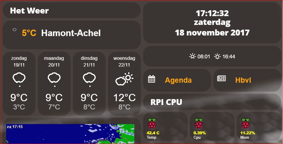

following problem (picture).
I would like to get the text and data from the RPI CPU sections/blocks to the right of the raspberry image.
I can do this by changing the block width from 3 to 4 , but then the blocks get under eachother!
And wile i have don this , and hover over the block , the text movs back to the underside of the picture??
How can i make the block HIGHER?
don't seem to find the methode??

I think in this case you have to play around with:
- image size
- text size
- right or left margins
Hardware:
dagger38
Posts: 40
Joined: Wednesday 01 November 2017 17:01
Domoticz version: 3.8153
Location: Belgium Achel
Post by dagger38 »
htilburgs wrote: Saturday 18 November 2017 18:34 I think in this case you have to play around with:
- image size
- text size
text size is not working... smaller , still under the picture.
Image size?? , were do i change that
same for the margins?? in custum.css?
My system:
1 Raspberry Pi 3
1 Rfx-Trx 433 module
1 Milight module
1 aeotec Zwave stick
1 Philips Home Bridge
3 Qubino ZMNHBDx Flush 2 Relays
2 FIBARO System FGS223 Double Relay
1 Niko home system
htilburgs
Posts: 464
Post by htilburgs »
I think you use a png file for the image, make it smaller and place new one in img folder.
Margins is indeed done in custom.css

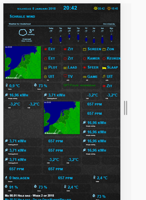

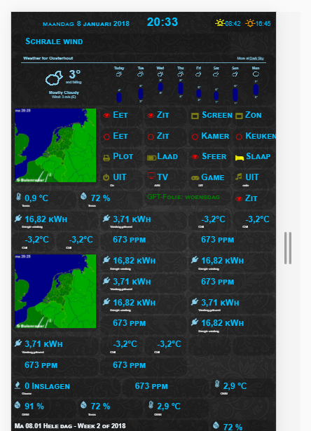

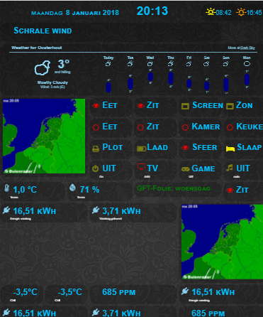

Dear...
I hope here is some one that can help me..
I have a vertical tablet 13 inch...
I try to make a dash with 1 column.... [ to save space and more freedom to use ]
There is my problem i think....
I will try to have buienradar on the right [ here come my ip when i have that working ]
Only what i try i cannot hold the button to left. eand on the right side have other blocks
For example here is the setup i wil have.:
When i try to set mor blocks before or after the button. the button is going to the left.
or:
I now i have to count with 12. all the blocks are 4 [ around the button ] unfortunately i cannot get the good setup.
is there perhaps a option to fix the button to richt?
robgeerts
Posts: 1273
Domoticz version: 3.7067
Post by robgeerts »
Don't you have to move the blocks around, for example:
If you have this:
columns[1]['blocks'] = [123,456,789,buttons.buienradar];
Change it to this:
columns[1]['blocks'] = [123,456,buttons.buienradar,789];
Derik
Posts: 1605
Post by Derik »
mm Id di try this:
'3185_2',		// [4] P1 vrbruik / dag
'315_5',		// [4] P1 opleveren / dag
10013,			// [2] Windchill
buttons.buienradar,	// [4]  Webcam test moet een ip camera worden
9298,			// [4] USB Co2
'3185_5',		// [4] P1 opleveren / dag
'3185_2',		// [4] P1 vrbruik / dag8
And this:
'3185_2',		// [4] P1 verbruik / dag
Only the button is not fixed on the right.
It is moving to left or going down
how i try to count to 12, in every row make no differences.
Derik
Posts: 1605
Post by Derik »
please some one?? is there no htmlcode to fix the camera [ buienradar button ] to the right side..?
