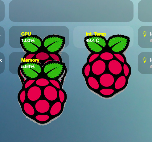

Re: Dashticz - Bug report
Posted: Thursday 23 November 2017 12:16
by EdwinK
Screen Shot 2017-11-23 at 12.15.02.png (309.49 KiB) Viewed 3173 times
Now I've got this little problem. Not to serious, just need to resize them myself ;)
