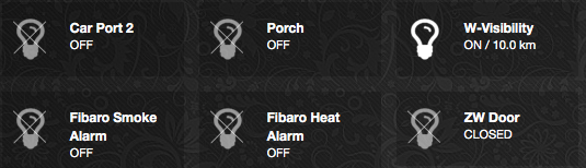

Suggested enhancements
1. An icon for a door open/close sensor.
2. In here - W-Visibility is a Wunderground device and 3. can we get an icon for the Alarms.

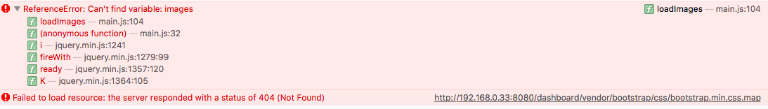

A couple of errors I spotted in the debug console on Safari:
all the best
Ian

whiteduck wrote:Suggested enhancements
Fixed in latest version!

whiteduck wrote:A couple of errors I spotted in the debug console on Safari:
Fixed the first one (images not defined)

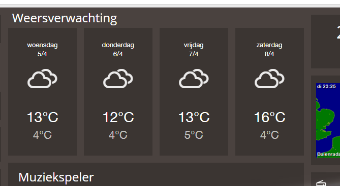

Pretty minor issue
The weather prediction title doesn't have a dark background as the other titles have, see:
I'm using the version of about 22:50 today. I really like the new updates with the image and button options

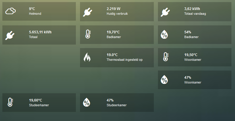

I've moved the Toon Setpoint to my switches block, because that's more logical for me. I already had a Thermostat Selector Switch in that block.
I tried to get a setpoint value to the status block (like in previous versions), but can't get it to work. Can you give me a hint please.
This is what I tried:
else if((data.result[r]['Type']=='Thermostat' || data.result[r]['HardwareType']=='Toon Thermostat') && data.result[r]['SubType']=='SetPoint'){

pvm wrote:Pretty minor issue
The weather prediction title doesn't have a dark background as the other titles have, see:opmaak.png

Almost as if I want it for me to look :) Almost.
Just the two bottom (wind and barometer) should go up a little more.
*note to self: move all of the 'states', including the last </div> to just above 'sliders'.

EdKo66 wrote: Just the two bottom (wind and barometer) should go up a little more.
Could you test if this is working, add to creative.css:
.states > div {
	height:75px;
#switches > div {
	height:85px;
(or download latest version)
