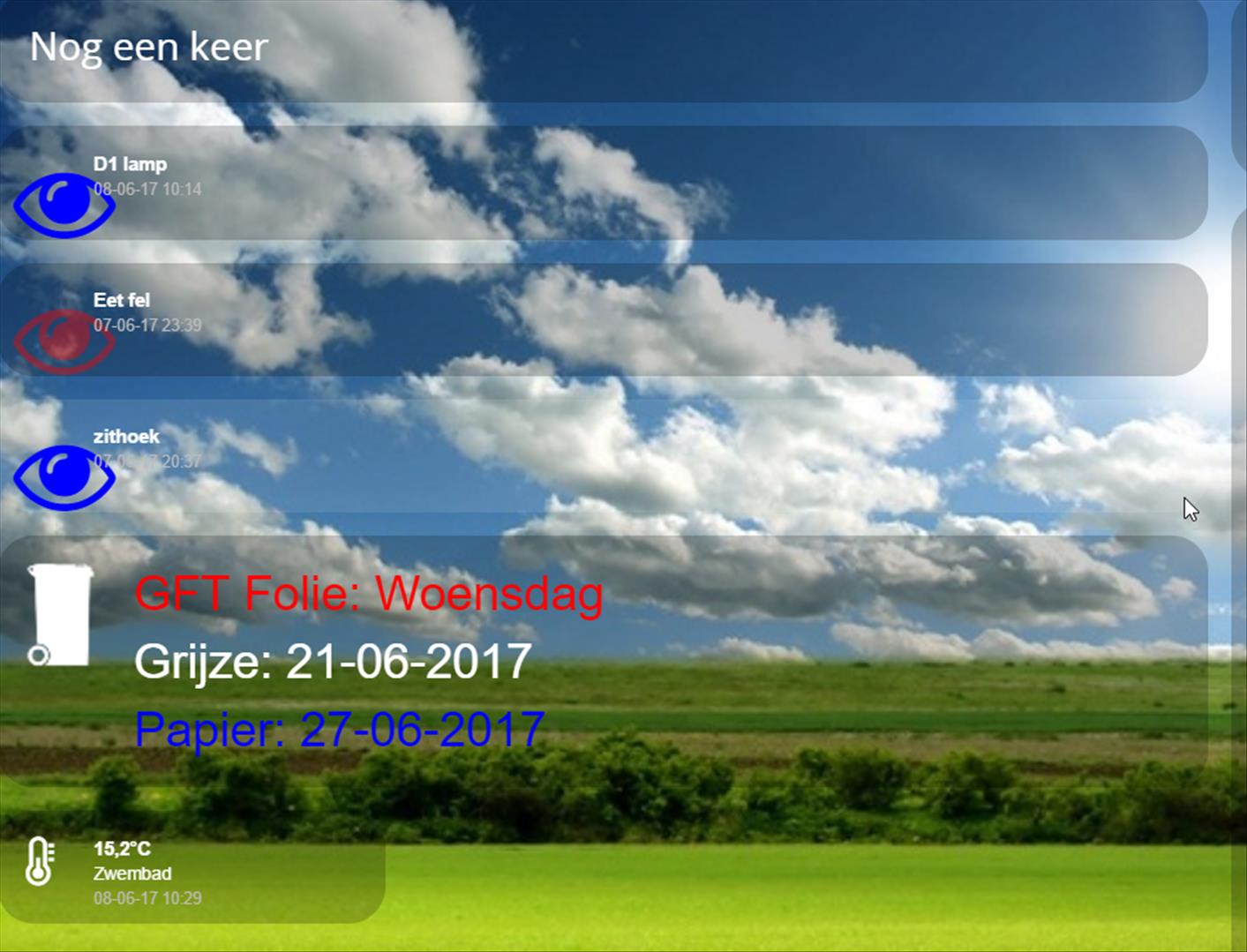

Derik
Posts: 1605
Post by Derik »
mmm
Is there a option to set/adjust all tekst in the switches:
I will try set all the tekst on my favorite place.
The heads and the info..colars etc etc
Perhaps under the block if possible? [ standard color of the switch is no problem ]
blocks['s13'] = {}
blocks['s13']['width'] = 12; //1 to 12, remove this line if you want to use the default (4)
blocks['s13']['title'] = 'zithoek'; //if you want change the name of switch different then domoticz
blocks['s13']['icon'] = 'fa-eye'; //if you want an other icon instead of the default, choose from: http://fontawesome.io/cheatsheet/
blocks['s13']['image'] = 'bulb_off.png'; //if you want to show an image instead if icon, place image in img/ folder
blocks['s13']['switch'] = true; //if you want to switch the title and data
blocks['s13']['hide_data'] = true; //if you want to hide the data of this block
blocks['s13']['show_lastupdate'] = true; //if you want to show the last update specific for this block
blocks['s13']['playsound'] = 'sounds/ping.mp3'; //play a sound when a device changes
blocks['s13']['protected'] = false; //protect switching manually in Dashticz
Or in the css
And i hope i can change the colors from the inside devices.
Like the colors and fontsize of the weather tekst and icon.
And the clock
And an option to set the clock data in 1 line.
And some more adjustable nice options..
[a css from someone i liketo puzzle ]

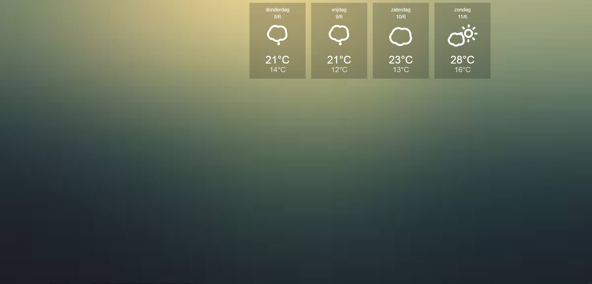

Yustmenl wrote:Hopefully someone can help me,
I installed Dashticz on my synology and edited the config.js
var _LANGUAGE 				= 'nl_NL'; //or: en_US, fr_FR, hu_HU
var _HOST_DOMOTICZ		  	= 'http://xxx.xxx.xxx.xxx:8080';
var _DOMOTICZ_REFRESH		= 3; //in seconds
var _DASHTICZ_REFRESH		= 5; //in minutes
var _THEME 					= 'default'; // default = dashticz default theme
var _HOST_ZIGGO_HORIZON	  	= ''; //e.g. http://192.168.1.3/domoticz/switch_horizon.php';
var _APIKEY_WUNDERGROUND  	= 'xxxx';
var _WEATHER_CITY 			= 'xxx';
var _WEATHER_CITYNAME 		= ''; //show a different city name, leave empty if same as _WEATHER_CITY
var _WEATHER_COUNTRY 		= 'NL';
var _USE_AUTO_POSITIONING 	= false; //don't want to configure positions, use auto positioning
var _USE_FAVORITES			= false; //only used when using auto positioning
var _HIDE_SECONDS_IN_CLOCK  = false; //do not show the seconds in the clock
var _NEWS_RSSFEED			= 'http://www.nu.nl/rss/algemeen';
var _USE_FAHRENHEIT			= false;
var _USE_BEAUFORT 			= false; //Bft instead of m/s
var _TRANSLATE_SPEED 		= false; //windspeed, north northwest instead of NNW
var _STANDBY_AFTER_MINUTES  = false; //enter amount of minutes like: 5 (5 minutes)
var _SCROLL_NEWS_AFTER 		= 7000; //milliseconds, so 7000 is 7 seconds
var _SHOW_LASTUPDATE 		= true;
var _LASTUPDATE_FORMAT 		= 'DD-MM-YY HH:mm';
var _SCREENSLIDER_EFFECT 	= 'slide'; //'slide' or 'fade' or 'cube' or 'coverflow' or 'flip'
//var _APIKEY_MAPS			= '';
//var _MAPS_LATITUDE			= '';
//ar _MAPS_LONGITUDE			= '';
//var _AUTO_SWIPEBACK_TO		= 1; //when no activity, swipe back to main screen after x seconds
//var _AUTO_SWIPEBACK_TIME	= 10; //seconds
var buttons = {}
//buttons.moon= {width:12, isimage:true, refreshimage:60000, image: 'moon'}
//buttons.calendar = {mijn kalendar'}
//buttons.buienradar = {width:12, isimage:true, image: 'http://api.buienradar.nl/image/1.0/RadarMapNL?w=285&h=256'}
//buttons.nunl = {width:12, icon: 'fa-newspaper-o', title: 'Nu.nl', url: 'http://www.nu.nl'}
//CUSTOM POSITIONING;
//defining wich blocks to show, de numbers represents the IDX of the device in Domoticz
//only define if you want to use a custom width instead of the default
var blocks = {}
blocks['blocktitle_1'] = {}
blocks['blocktitle_1']['title'] = 'Schakelaars'
blocks[93] = {}//schemerlanp woonkamer
blocks[93]['width'] = 4; //1 to 12, remove this line if you want to use the default (4)
//defining number of columns, their contents en widths
//width can be a number 1 to 12, but total widths of all columns should always be 12
columns[1] = {}
columns[1]['blocks'] = ['blocktitle_1',93]
columns[1]['width'] = 12;
I used possitioning and favorites as true and false in all combinations but i don't get any information on my screen
so i also tryed to add switches manualy and this also doesn't get anything on screen.
the only thin i get is the WU blocks
when i look at http://xxx.xxx.xxx.xxx:8080/json.htm?ty ... favorite=1
it shows all the favorites.
hopefully someone can point me in the right direction.
You are missing var columns = {}
var screens = {}
screens[1] = {}
screens[1]['background'] = 'bg1.jpg';
screens[1]['columns'] = [1]
Blah blah blah
Yustmenl
Posts: 24
Joined: Wednesday 28 September 2016 17:26
Domoticz version: 3.5997
Post by Yustmenl »
thanks, i missed those.
