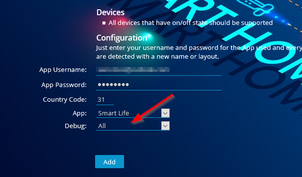

I have no idea why your Domoticz crash, but can you put the plug-in debug to all maybe we can get more info.
Re: Python Plugin: TUYA
Posted: Saturday 01 May 2021 21:56
by Bobby08
Thanks for your quickness, i just check and this is the "all" tab i have copied.
Or maybe i don't understand

by Xenomes
Set the debug in the plug-in to all.
2021-05-01 22_06_13-Window.png (230.3 KiB) Viewed 2113 times
