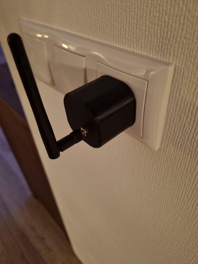

For a few weeks back i had a ikea router.
But i was not happy with it. The zigbee network lines where gone and a couple of devices didn't work.
Removed the ikea router, and after a reboot of zigbee2mqtt, the devices worked again.
But i still needed a router.
Ordered the parts for a cc2530-cc2591.
Made a housing for it and now i have a smill, this works much better than the ikea router

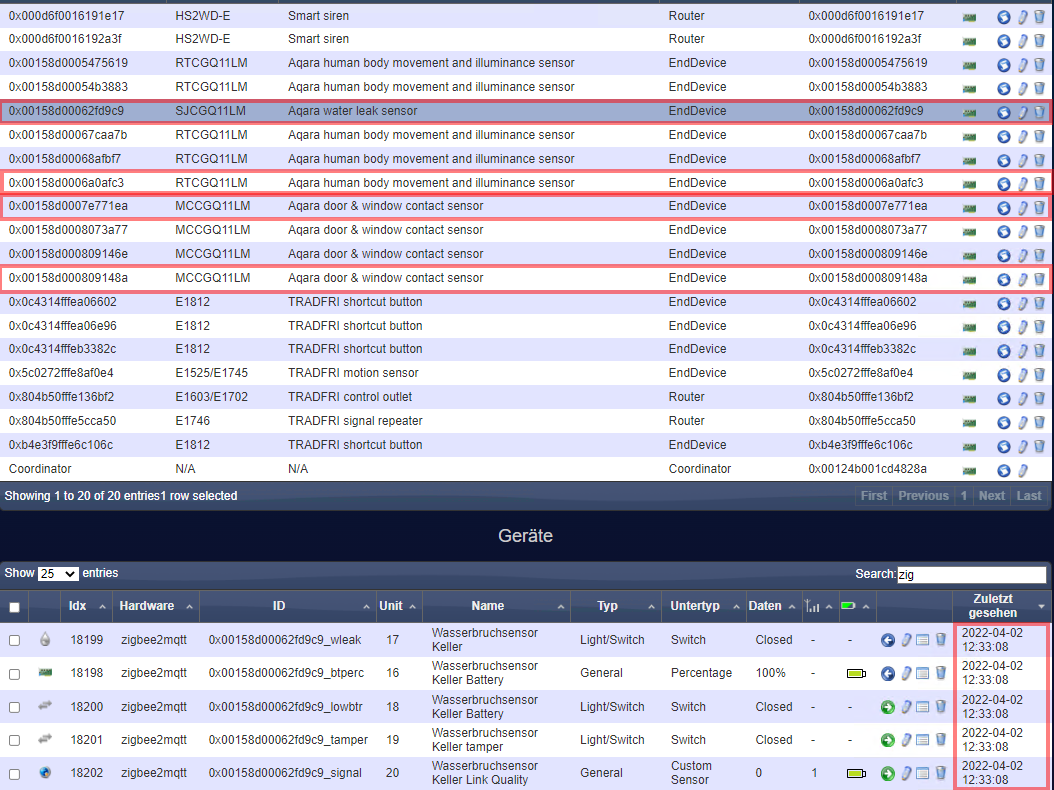

Since 2022.04.02 I have Problems with some of my Devices, not all, just some.
I tried to restart mosquito, restart the Raspi, restart Domoticz also and the zigbee2mqtt.
All running on the same Raspi and working fine since Weeks now.
What can i try to get them running again?
Anyone idea welcome :)
