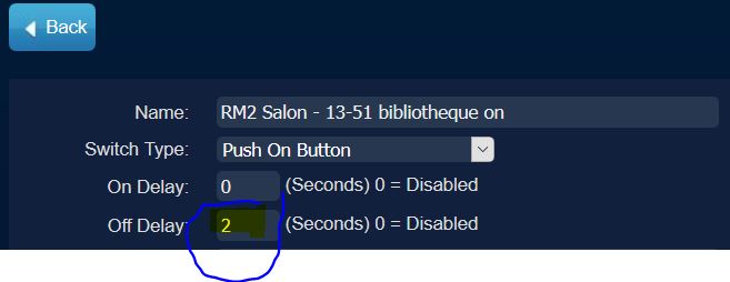

Learned code disappearing magically from ini file!
I use version 0.9 and RM Pro+, attached to domoticz using standard approach - everything ok.
Then I created a ini file using learn mode induced from domoticz web interface - "command" device, generate and import.
Created device has "Push On" style.
when I manually (from web) switch on the device, it send the learned string, light was switched on and device state in web goto "red button" - everything OK.
Second push to the button (red in web interface) do nothing, device does not blink and do not send anything, it in "On" state. :?
So, because I use it for light switch on/off, I choose to change button style. I goto in web and choose "edit" for the generated device and change its style to "On/Off".
Ok, I press it - it works for first time, send string and it works :D .
Then I try to press the same device again and nothing happens. :oops:
I check ini file in the plugin directory and found this magically "Learned" section disappears from it!
I try to restore it, then repeat even reboot competely domoticz - problem still the same: if I switch on generated device which I moved to "On/Off" style - Learned section disappears from ini file!
So. what should I do?

torM6 wrote: Saturday 09 June 2018 0:51 Learned code disappearing magically from ini file!
thanks for reporting, will take a look on that.. but no make sense to have other type that push button for this device, it's like a remote...just put some delay into the generated button e.g
torM6
Posts: 18
Joined: Tuesday 29 May 2018 18:11
Domoticz version: 3.9390
Re: Python Plugin : Broadlink RM2 V4
Post by torM6 »
will try.
but, what is a meaning for this?
if state of device "off" then when I press device icon what happens? why I need this 2 sec delay?
I assume that if device off - then string go out for switching on, for on - string to off. and by default these 2 strings are the same and taken from "Learned" section? what changes will give 2 sec delay?
By the wa, I suspect also some problem with learning mode - it does not switch off after learning, or even after "Reset" option choosen.
may be it still consider that device is in learning mode... (while no orange blinking light present on device). even after reboot of server with domoticz (I use Synology NAS)
but this is just assumption

found temporary solution
need to setup
customname = name of the device in domoticz
then it do not try to update ini and do not kill sections
