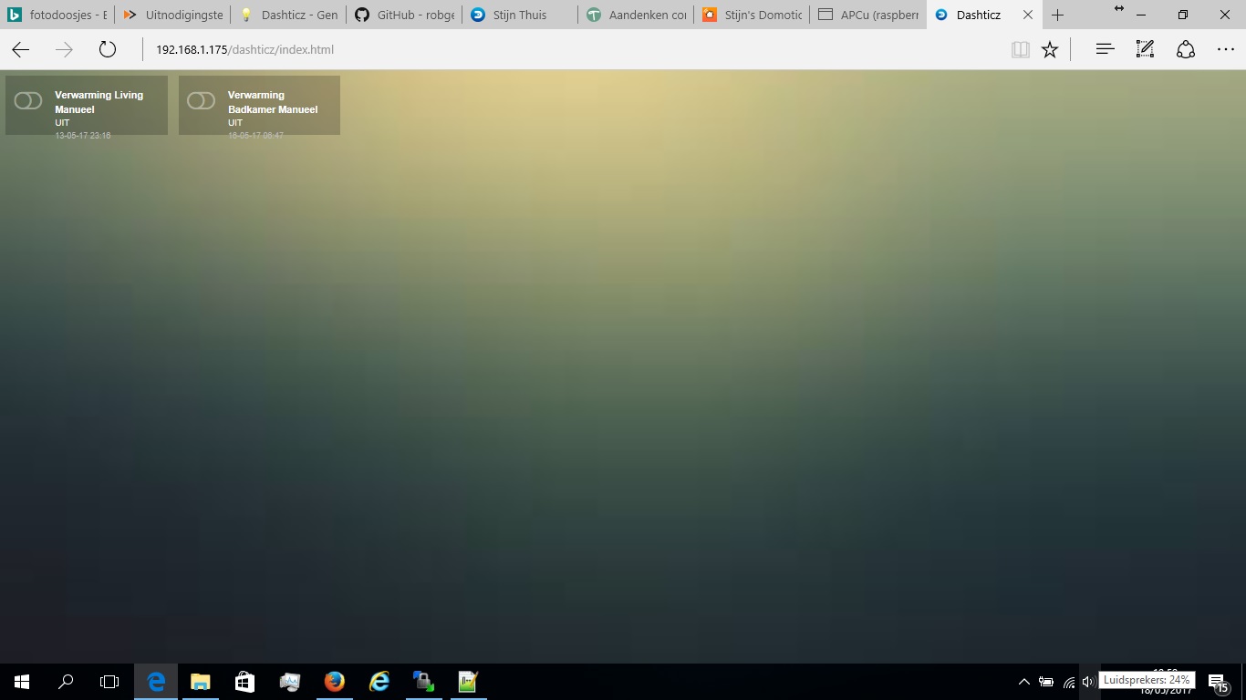

ropske
Posts: 483
Domoticz version: V3_8394
Location: Rumbeke,Belgium
Post by ropske »
now i got this:
but i have a lot of temperatures added to my favorites, but dashticz does not show any of them
htilburgs
Posts: 464
Post by htilburgs »
Ok, but this is more than before...;-)
Maybe the temperatures are not recognized by Dashticz. Can you post the output of:
http://192.168.1.175:8080/json.htm?type ... order=Name
