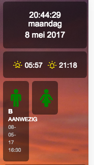

SwordFish
- Posts: 278
- Joined: Sunday 14 December 2014 12:28
- Domoticz version: V4.11375
That didn't work, sorry ( did also clear cache )Try to use this:
added : if(_SHOW_LASTUPDATE) html+='<br /><span class="lastupdate">'+moment(device['LastUpdate']).format(_LASTUPDATE_FORMAT)+'</span>';Code: Select all
function getBlock_338(device,idx){ //change 233 to the idx of your device! $('.block_'+idx).attr('onclick','switchDevice(this)'); var html=''; html+='<div class="col-xs-4 col-icon">'; if(device['Status']=='Off') html+=iconORimage(idx,'fa-toggle-off','','off icon'); else html+=iconORimage(idx,'fa-toggle-on','','on icon'); html+='</div>'; html+='<div class="col-xs-8 col-data">'; html+='<strong class="title">'+device['Name']+'</strong><br />'; if(device['Status']=='Off') html+='<span class="state">Afwezig</span>'; else html+='<span class="state">Aanwezig</span>'; if(_SHOW_LASTUPDATE) html+='<br /><span class="lastupdate">'+moment(device['LastUpdate']).format(_LASTUPDATE_FORMAT)+'</span>'; html+='</div>'; return html; }
bsmeding
- Posts: 34
- Joined: Tuesday 28 October 2014 18:29
and the variable _SHOW_LASTUPDATE = true in CONFIG.js?
bsmeding
- Posts: 34
If I change it it works
also check if you don't hide it in the blocks settings
in CONFIG.js
in custom.js
you can also force the update to change the line
to
in CONFIG.js
var _SHOW_LASTUPDATE = true;
var _LASTUPDATE_FORMAT = 'DD-MM-YY HH:mm'
and
blocks[402] = {}
blocks[402]['icon'] = 'fa-male';
blocks[402]['title'] = 'B';
function getBlock_402(device,idx){ //change 233 to the idx of your device!
var html='';
html+='</div>';
if(device['Status']=='Off') html+='<span class="state">AFWEZIG</span>';
else html+='<span class="state">AANWEZIG</span>';
html+='</div>';
return html;
to
- Schermafbeelding 2017-05-08 om 20.44.27.png (95.13 KiB) Viewed 2697 times
