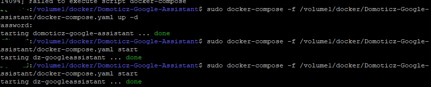

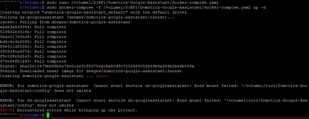

Hello everyone,
I'm having some problem to start DZGA on my RS815+ with docker.
I succesfully installed the DZGA docker but when I run "sudo docker-compose -f /volume1/${USER}/Domoticz-Google-Assistant/docker-compose.yaml up -d" it returns with this error:
The default_config file is in the config folder.
Thank you in advance :roll:

fabry91 wrote: Tuesday 21 December 2021 10:44 Hello everyone,

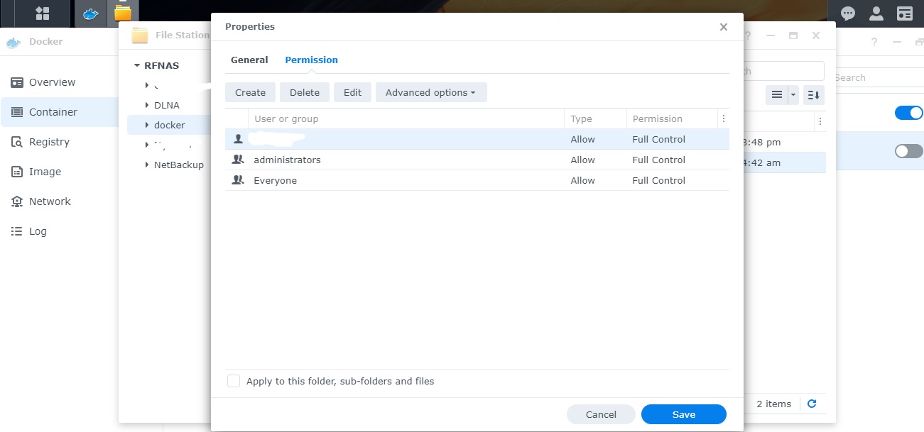

Hello, and thank you for your reply!
I've cheched all the permission under file station, I set all to "Full Control", the container starts but after some seconds it stops automatically.

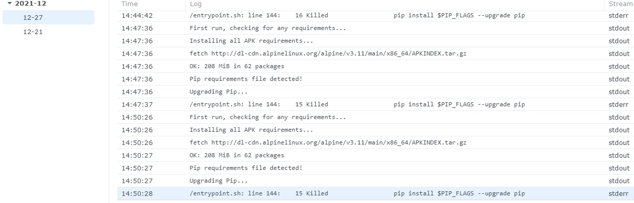

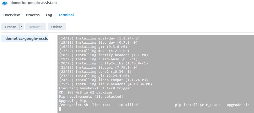

vodor wrote: Monday 27 December 2021 15:40 I don't know the synology nas devices. I use a qnap myself but that error is pretty much a standard docker error when it cannot find and/or mount a volume. So I would go read up on that if I am you.
Have found some more error that seems related to this post on GitHub:
https://github.com/DewGew/Domoticz-Goog ... issues/205
here there is the complete log of the restarting of the container on Synology:
2021-12-31 10:17:41 stdout Upgrading Pip...
2021-12-31 10:17:41 stdout Pip requirements file detected!
2021-12-31 10:17:41 stdout OK: 208 MiB in 62 packages
2021-12-31 10:17:41 stdout fetch http://dl-cdn.alpinelinux.org/alpine/v3 ... DEX.tar.gz
2021-12-31 10:17:41 stdout Installing all APK requirements...
2021-12-31 10:17:41 stdout First run, checking for any requirements...
2021-12-31 10:17:37 stderr /entrypoint.sh: line 144: 16 Killed pip install $PIP_FLAGS --upgrade pip
2021-12-31 10:17:35 stdout Upgrading Pip...
2021-12-31 10:17:35 stdout Pip requirements file detected!
2021-12-31 10:17:35 stdout OK: 208 MiB in 62 packages
2021-12-31 10:17:35 stdout fetch http://dl-cdn.alpinelinux.org/alpine/v3 ... DEX.tar.gz
2021-12-31 10:17:35 stdout Installing all APK requirements...
2021-12-31 10:17:35 stdout First run, checking for any requirements...
2021-12-31 10:17:32 stderr /entrypoint.sh: line 144: 16 Killed pip install $PIP_FLAGS --upgrade pip
2021-12-31 10:17:31 stdout Upgrading Pip...
2021-12-31 10:17:31 stdout Pip requirements file detected!
2021-12-31 10:17:31 stdout OK: 208 MiB in 62 packages
2021-12-31 10:17:30 stdout fetch http://dl-cdn.alpinelinux.org/alpine/v3 ... DEX.tar.gz
2021-12-31 10:17:30 stdout Installing all APK requirements...
2021-12-31 10:17:30 stdout First run, checking for any requirements...
2021-12-31 10:17:28 stderr /entrypoint.sh: line 144: 16 Killed pip install $PIP_FLAGS --upgrade pip
2021-12-31 10:17:27 stdout Upgrading Pip...
2021-12-31 10:17:27 stdout Pip requirements file detected!
2021-12-31 10:17:27 stdout OK: 208 MiB in 62 packages
2021-12-31 10:17:27 stdout fetch http://dl-cdn.alpinelinux.org/alpine/v3 ... DEX.tar.gz
2021-12-31 10:17:27 stdout Installing all APK requirements...
2021-12-31 10:17:27 stdout First run, checking for any requirements...
2021-12-31 10:17:25 stderr /entrypoint.sh: line 144: 15 Killed pip install $PIP_FLAGS --upgrade pip
2021-12-31 10:17:24 stdout Upgrading Pip...
2021-12-31 10:17:24 stdout Pip requirements file detected!
2021-12-31 10:17:24 stdout OK: 208 MiB in 62 packages
2021-12-31 10:17:24 stdout fetch http://dl-cdn.alpinelinux.org/alpine/v3 ... DEX.tar.gz
2021-12-31 10:17:24 stdout Installing all APK requirements...
2021-12-31 10:17:24 stdout First run, checking for any requirements...
2021-12-31 10:17:23 stderr /entrypoint.sh: line 144: 15 Killed pip install $PIP_FLAGS --upgrade pip
2021-12-31 10:17:21 stdout Upgrading Pip...
2021-12-31 10:17:21 stdout Pip requirements file detected!
2021-12-31 10:17:21 stdout OK: 208 MiB in 62 packages
2021-12-31 10:17:21 stdout fetch http://dl-cdn.alpinelinux.org/alpine/v3 ... DEX.tar.gz
2021-12-31 10:17:21 stdout Installing all APK requirements...
2021-12-31 10:17:21 stdout First run, checking for any requirements...
2021-12-31 10:17:19 stderr /entrypoint.sh: line 144: 17 Killed pip install $PIP_FLAGS --upgrade pip
2021-12-31 10:17:16 stdout Upgrading Pip...
2021-12-31 10:17:16 stdout Pip requirements file detected!
2021-12-31 10:17:16 stdout OK: 208 MiB in 62 packages
2021-12-31 10:17:16 stdout Executing busybox-1.31.1-r9.trigger
2021-12-31 10:17:15 stdout (25/25) Installing linux-headers (4.19.36-r0)
2021-12-31 10:17:15 stdout (24/25) Installing libc6-compat (1.1.24-r3)
2021-12-31 10:17:13 stdout (23/25) Installing git (2.24.4-r0)
2021-12-31 10:17:13 stdout (22/25) Installing pcre2 (10.34-r1)
2021-12-31 10:17:13 stdout (21/25) Installing libcurl (7.79.1-r0)
2021-12-31 10:17:13 stdout (20/25) Installing nghttp2-libs (1.40.0-r1)
2021-12-31 10:17:13 stdout (19/25) Installing build-base (0.5-r1)
2021-12-31 10:17:13 stdout (18/25) Installing fortify-headers (1.1-r0)
2021-12-31 10:17:13 stdout (17/25) Installing make (4.2.1-r2)
2021-12-31 10:17:07 stdout (16/25) Installing g++ (9.3.0-r0)
2021-12-31 10:17:07 stdout (15/25) Installing libc-dev (0.7.2-r0)
2021-12-31 10:17:06 stdout (14/25) Installing musl-dev (1.1.24-r3)
2021-12-31 10:16:58 stdout (13/25) Installing gcc (9.3.0-r0)
2021-12-31 10:16:58 stdout (12/25) Installing mpc1 (1.1.0-r1)
2021-12-31 10:16:58 stdout (11/25) Installing mpfr4 (4.0.2-r1)
2021-12-31 10:16:58 stdout (10/25) Installing libatomic (9.3.0-r0)
2021-12-31 10:16:58 stdout (9/25) Installing libgomp (9.3.0-r0)
2021-12-31 10:16:57 stdout (8/25) Installing isl (0.18-r0)
2021-12-31 10:16:57 stdout (7/25) Installing gmp (6.1.2-r1)
2021-12-31 10:16:57 stdout (6/25) Installing file (5.37-r1)
2021-12-31 10:16:57 stdout (5/25) Installing libmagic (5.37-r1)
2021-12-31 10:16:56 stdout (4/25) Installing binutils (2.33.1-r1)
2021-12-31 10:16:56 stdout (3/25) Installing libstdc++ (9.3.0-r0)
2021-12-31 10:16:56 stdout (2/25) Installing libgcc (9.3.0-r0)
2021-12-31 10:16:56 stdout (1/25) Upgrading musl (1.1.24-r2 -> 1.1.24-r3)
2021-12-31 10:16:56 stdout fetch http://dl-cdn.alpinelinux.org/alpine/v3 ... DEX.tar.gz
2021-12-31 10:16:56 stdout Installing all APK requirements...
2021-12-31 10:16:56 stdout First run, checking for any requirements...

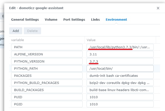

I also noticed that the file in "/usr/local/lib/" named "python3.7.3" does not exsist in that path :?
pip error.jpg (111.74 KiB) Viewed 3014 times

Your docker cannot access the volume location you specified volume1. Check permissions and or try and move it to another location and confirm docker has permissions to read/write to it
Hello, anyone can help me to solve this problem about the pip installation failed?
This is what happend when I run
docker-compose -f /volume1/docker/Domoticz-Google-Assistant/docker-compose.yaml up -d
