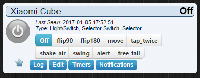

@deennoo,
Is this how you would see the cube device in Domoticz?
If you are still setup to compile, try my update that should detect the cube: https://github.com/corbinmunce/domoticz

corbin wrote:@deennoo,
Result :
XiaomiGateway: cube rotate not handled:
and domoticz stop reciving data from gateway
http://domo-attitude.fr
corbin
Posts: 463
Location: Brisbane, Australia
Post by corbin »
Please compile my source again, I made an error first time.
deennoo
Posts: 784
Location: Bordeaux France
Post by deennoo »
try it and now :
2017-01-05 12:46:33.120 {"cmd":"read_ack","model":"switch","sid":"158d000125664f","short_id":27474,"data":"{}"}
2017-01-05 12:46:33.120 XiaomiGateway: unhandled model:
2017-01-05 12:46:33.120 {"cmd":"read_ack","model":"","sid":"158d00010eebac","short_id":31286,"data":"{}"}

deennoo wrote:try it and now :
Can you fire up wireshark to see what messages are being sent?
looks like an incomplete response, as there is no "model" being returned. Can you tell if "158d00010eebac" is your Xiaomi cube?
When you create a motion with the cube, is it returning a {"cmd":"report"...} response?
Just thinking, since there is a response, but incomplete, maybe a firmware update is needed. Since this is only new, maybe that firmware update is not available just yet?
