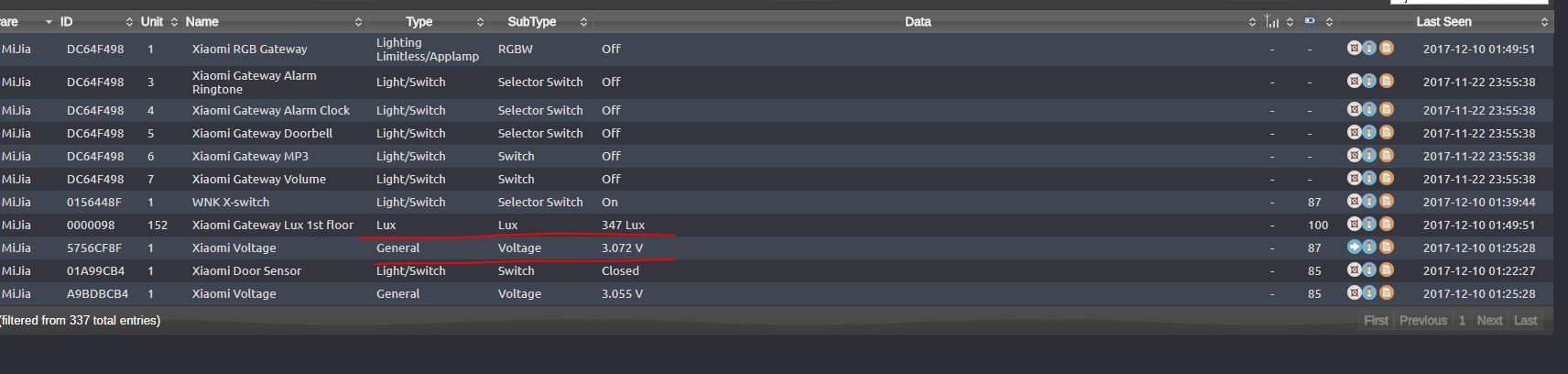

I have just added a motion sensor (Aqara) to the gateway. In Domoticz I found the voltage and the lux sensor in the Devices tab. But there is not motion switch present. Does anyone have the same issue and how to fix this??
Or may be is the lux sensor from the gateway and the voltage is from the switch. And that Domoticz has not discovered the Motion Sensor yet.
If true, do I have to remove Motion sensor in the Xiaomi App and add the device again??

Chakkie wrote: Sunday 10 December 2017 1:54 Hi guys,
If you are running Stable version you have to switch to beta version.

glsf91 wrote: Sunday 10 December 2017 9:06
Thanks that is why I don't see the motion sensor in Domoticz. So I have to wait for the next stable or go straight to the beta.
