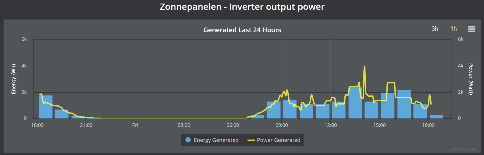

Plenty of error here as well, and if I look at my graph of the past 24 hours, it looks like the Goodwe servers are overloaded from 10:00 CET to roughly 17:30. I get decent updates during the evening, night, but during the day a large part of the requests are timing out.

I am pretty sure it is an overloading of the GoodWe servers that is causing this.
This morning was better than most other recent days, but this afternoon the timeouts started to increase again.

JanJaap wrote: Sunday 18 December 2022 14:14 OK, so Dylian stopped maintaining that plugin a couple of years ago (it is set to archived for that). So first thing to do is remove the old version and then you need to follow instructions and pull from here: JanJaapKo - GoodweSEMS. Then secondly, make sure to select the right one in the hardware page:
Thank you for the guidance. I followed the steps for the API, and everything worked really well. Much appreciated.
provedance
