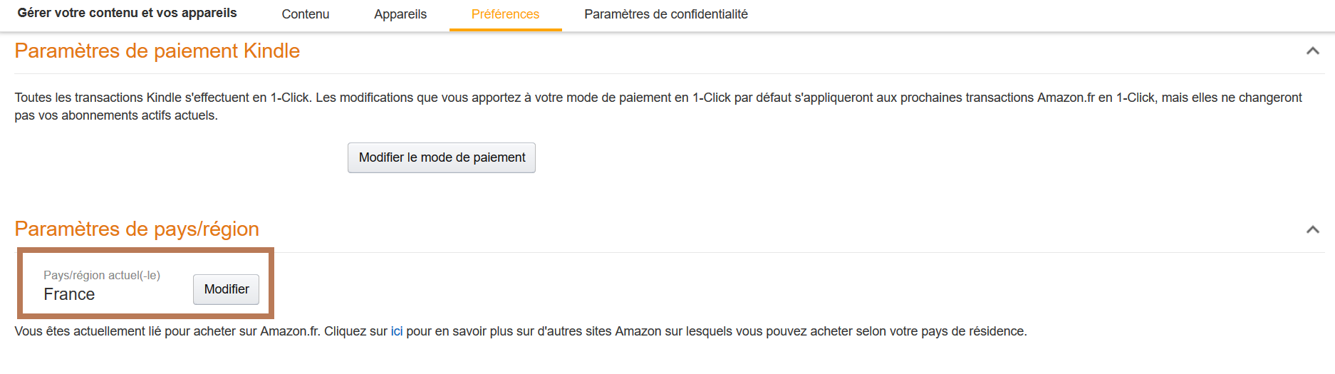

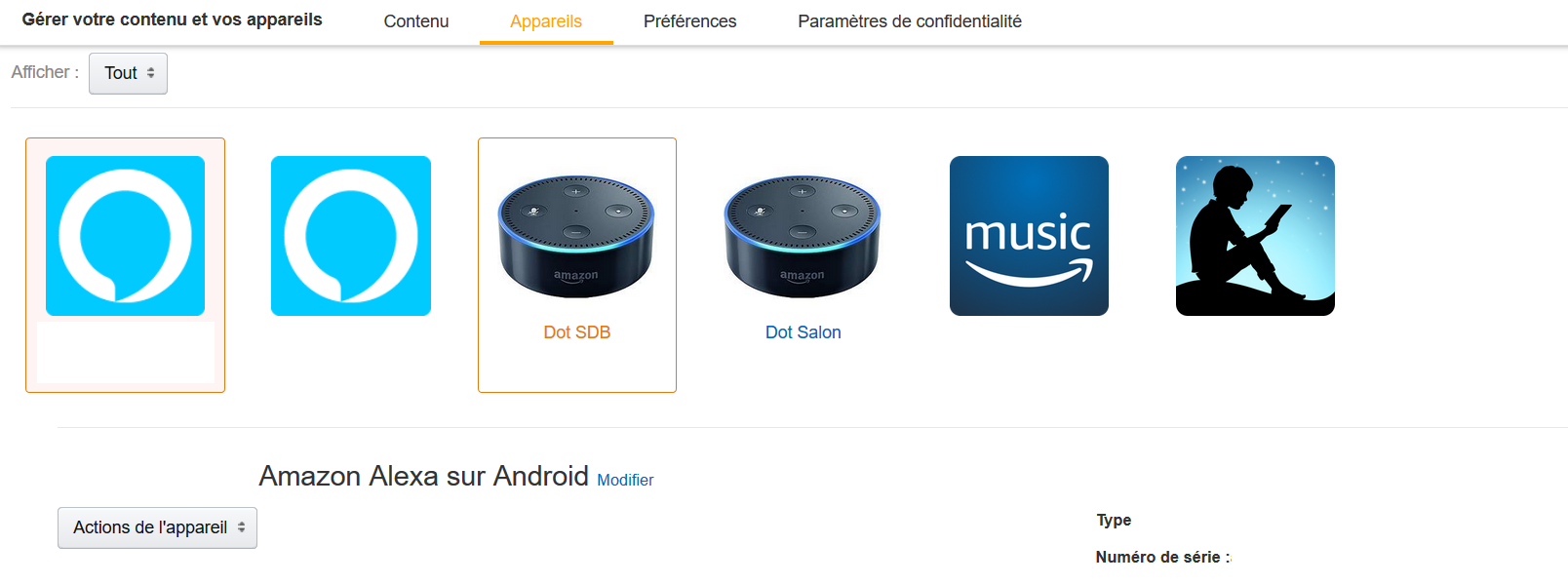

If you're having empty devices on your french Amazon account, it seems your default region/country is not set to FR.
Here is my information regarding the region :
And i can see my devices as well :
When i'm logging to alexa.amazon.com, Amazon is redirecting me to alexa.amazon.fr and asking to login again to the french site.
In order to solve your issue, you can try to transfert your account :
https://www.amazon.com/gp/help/customer ... =201248840
Or you can leave your account in the US and set the lambda in the US as well as it was working for other users :
trueblueswede wrote: Saturday 08 December 2018 11:41 @Damsee: I got it to work now, Very nice! In case someone runs into the same problem as I did here is what resolved my issues.
For some reason, it did not work to set the skill Language to EN(UK) and host the function in Ireland.
I exported the function and deployed it to Us(Virginia) and created a new skill with Language EN(Us) and voila it started to work.
Hope that helps ;)
