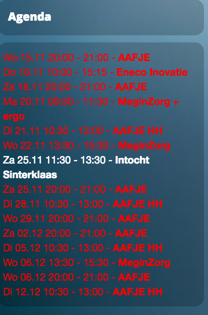

Is there a solution for the multiple days events?
I see no multiple days events in the dash:
Or is there something new that i mis?
var calendars = {}
calendars.Myname = {width:12, maxitems: 10, icon:'', title: 'My name', icalurl: 'https://calendar.google.com/calendar/ical/Myname%40gmail.com/private-326714rrrrrf324595985653a13dd91127c/basic.ics' }
robgeerts
- Posts: 1273
- Joined: Saturday 24 January 2015 22:12
- Domoticz version: 3.7067
Re: Dashticz - Module - Calendar
I do see my multiple day items... could you send me your ical-url via PM and tell me wich event you dont see.. (of course, I dont bother the events, just want to fix this).
