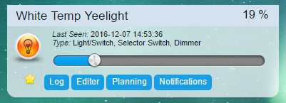

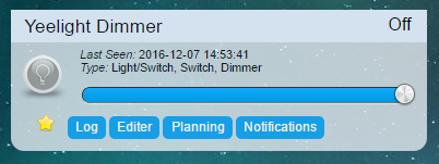

I made some dummy device and lua script to improve yeelight implantation, i think that natively domotigz have to add the device for each yeelight bulb
Interest of this dummy device : they can be trigger with api, or scene, or lua script
white temp yeelight.PNG (55.45 KiB) Viewed 2154 times
add to this lua script :
DomDevice = 'White Temp Yeelight';
IP = '192.168.0.207';
PORT = '55443'
--PIN = "4";
if devicechanged[DomDevice] then
   if(devicechanged[DomDevice]=='Off') then
     DomValue = 0;
     runcommandoff = "sudo echo -ne '{\"id\":1,\"method\":\"set_power\", \"params\":[\"off\", \"smooth\", 500]}\\r\\n' | nc -w1 " ..IP.." " ..PORT.."";;
     os.execute(runcommandoff);
     DomValue = otherdevices_svalues[DomDevice];
   CalcValue = ((DomValue-1) * 48)+1700;
   if CalcValue==nil then CalcValue=0 end
     runcommand = " sudo echo -ne '{\"id\":1, \"method\":\"set_scene\",\"params\":[\"ct\"," .. CalcValue .. ", 75]}\\r\\n' | nc -w1 " ..IP.." " ..PORT.."";
   os.execute(runcommand);
   print(runcommand)
   print("Color Temp= "..CalcValue);
return commandArray
turn automaticaly bulb and set it to the white temp color choose
yeelight dimmer.PNG (49.96 KiB) Viewed 2154 times
join to this script
[codecommandArray = {}
DomDevice = 'Yeelight Dimmer'; -- here name of your dimmer
TempDevice = 'White Temp Yeelight' -- here name of your white temperature slider
IP = 'youryeelightbulbip';
PORT = '55443'
     DomValue = 0;
    TempValue = otherdevices_svalues[TempDevice];
    CalcValue = ((TempValue-1) * 48)+1700;
     runcommand = "sudo echo -ne '{\"id\":1, \"method\":\"set_scene\", \"params\":[\"ct\", " .. CalcValue .. ", " .. DomValue .. "]}\\r\\n' | nc -w1 " ..IP.." " ..PORT.."";
   print(runcommand)
   print("bright value= "..DomValue);
return commandArray
This Dimmer turn automaticaly On and Off Yeelight Bulb to the dimmer value and the color temp choose on the Color temp Slider

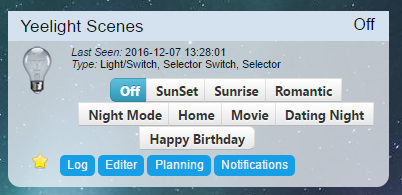

Yeelight Sceen selector :
yeelight sceen.PNG (63.19 KiB) Viewed 2154 times
Working on the lua script
This one allow to choose sceen, as disco can't work, and ccan not be call from the api, for yeelight bulb,
Want to add red alerte sceen need help from @weiweipossible to get mobile app scene if possible, send me an MP please.

corbin wrote:Good work guys, the way Domoticz works scripting is needed to do this fine control. It is a good thing you can make it do what you want rather than be limited to what the GUI offers.
Gui can be change, by using appropriate device (not the limitlessled ones who was done for another hardware
Exemple : for rgbw bulb
using a RGBW switch at creation instead of a limitless one (who add unusful button)
and add selector for pre registred scene
and dimmer slider set as a white temp slider.
bright dimmer can stay a dummy and lua script device, i made it for my comfort.
Easy to say, but surely not easy to do for none Domoticz c++ Dev
http://domo-attitude.fr

My solution was to use the white dummy dimmer + lua script and then trigger it from scene (it will turn bulb on and off)
