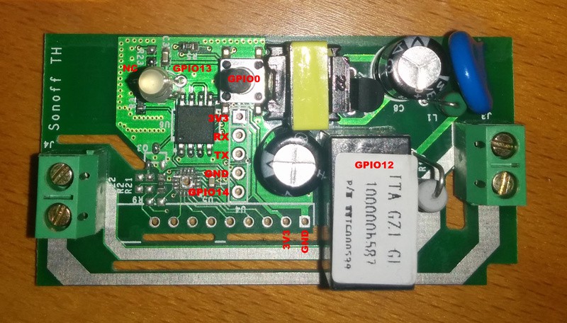

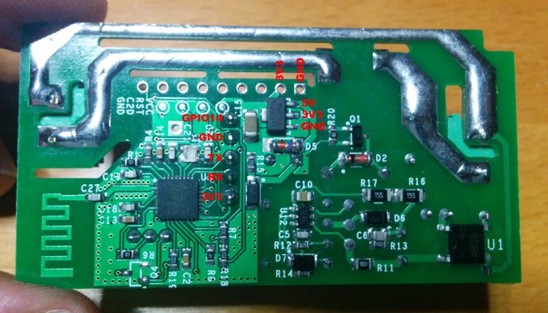

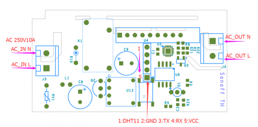

Just some images I also used to figure out the pins.

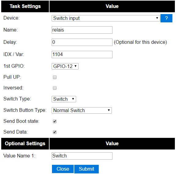

Just the settings for easy_setup.
ESPEasy settings for switching a bulb for example.
And at the bottom the settings for the virtual switch in domoticz.
On: http://IP_Address_of_Sonoff/control?cmd=GPIO,12,1
Off: http://IP_Address_of_Sonoff/control?cmd=GPIO,12,0
Ow and for the internal LED ;-)
On: http://IP_Address_of_Sonoff/control?cmd=GPIO,13,0
Off http://IP_Address_of_Sonoff/control?cmd=GPIO,13,1

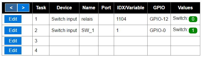

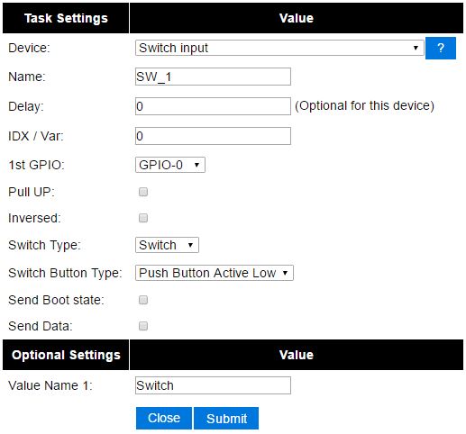

##UPDATE:
On the ESP Easy Under Tools -> Advanced, I enabled rules. http://www.letscontrolit.com/wiki/index ... rial_Rules
Under rules I entered:
on lamp_on do
    gpio,12,1
    gpio,13,0
endon
on lamp_off do
    gpio,12,0
    gpio,13,1
endon
on SW_1#Switch do
  if [SW_1#Switch]=1
    gpio,12,1
    gpio,13,0
    gpio,12,0
    gpio,13,1
  endif
endon
In this way If I call from domoticz:
On: http://IP_Address_of_Sonoff/control?cmd=event,lamp_on
Off: http://IP_Address_of_Sonoff/control?cmd=event,lamp_on
This will switch on / off the lamp AND the LED light inside of the Sonoff box. :D.
In addition pressing the PUSH button on the Sonoff will trigger the light as well and update the domoticz status.
A Slight modification in the device name was needed.
