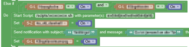

Hi guys,
i know this topic is very old but i was also struggeling with this issue and found no solution in the forums.
But I could now figuere out when this problem happen:
It happens ONLY if there are more then the "start script" action in the doing.
Example:
If a Blockly Script looks like this (only the Start Script action is selected, it will work:
If there are other actions in the "Do" section, Domoticz will tail the # after the script:
My Workaround: - "SOLUTION"
I Create a Dummy-Item (Push On Button) and added my script to the "action at on" field.
In the Blockly Script i will just set this dummy button to ON - then the Script will be executed.
I hope this can help other people with the same Issue.
Example:
