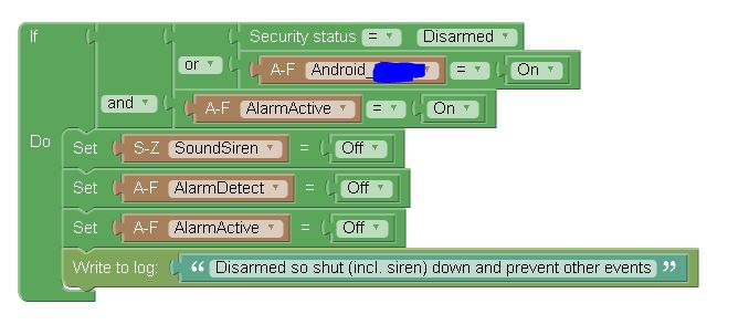

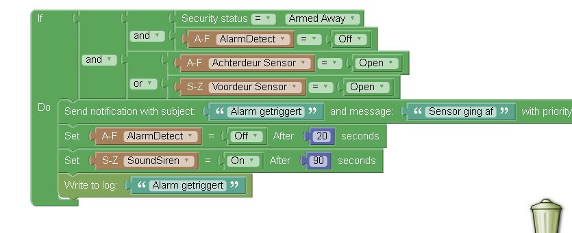

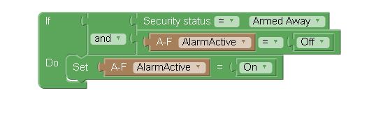

This is my config.
Alarm Off
MotionDetection
SetAlarm

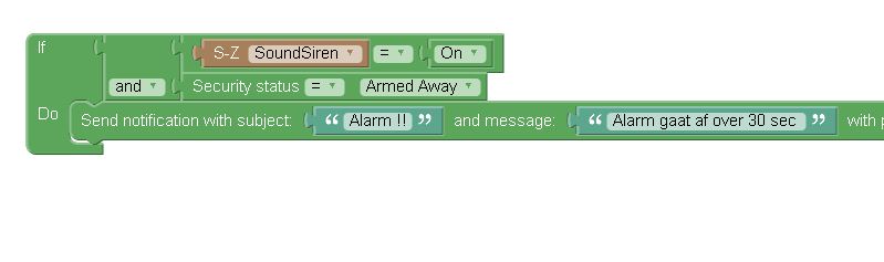

Re: Alarm system 'wiki'
Posted: Monday 11 January 2016 21:27
by spyseiko
Set Siren
Sound Siren
Posted: Monday 11 January 2016 22:17
by maomanna
in soundSiren you did not specify your siren itself.
Maybe it is in your case to set it to panic instead of On.
Posted: Wednesday 20 January 2016 12:57
by maomanna
I combined the blockly's from 5/6 blockly's to 1.
I see a little mistake:
I used 2 times PIR_SKvoor.
I changed it to my other PIR.
