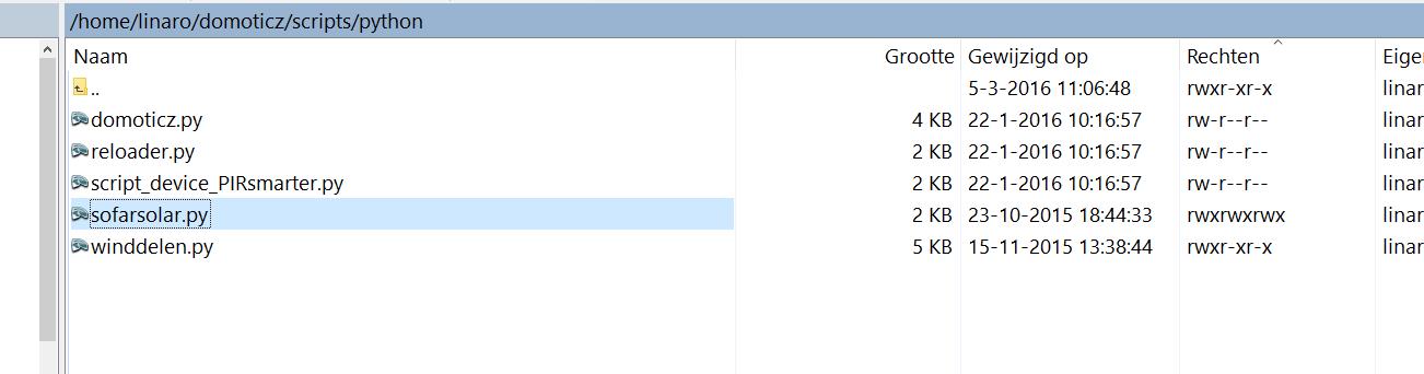

And the place:
And make it executable or something look @ the RWX

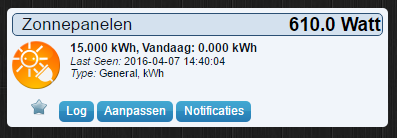

Which virtual sensor do i need to choose? I have chosen for the "Elektra (aktueel + teller)" but now i don't see decimal numbers.
