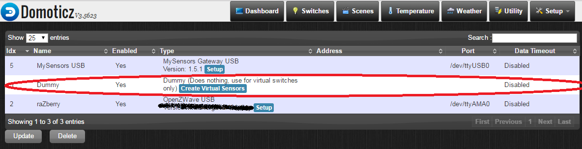

I have Domoticz running on RPi 2 and a Tellstick DUO. I am using Nexa and also other brands that use 433 MHz, works perfect.
1. I followed this page for installing Tellstick, https://blogg.itslav.nu/?p=875, it is in Swedish but you can run the Command and it shall work
2. Add Dummy hardware
3. Click on Create Virtual Sensor, choose "Switch" as Sensor Type and a name

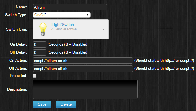

4. Go to Switches Tab, Edit the newly created Dummy
5. Switch Type shall be On/Off
6. Edit /etc/tellstick.conf
user = "nobody"
group = "plugdev"
deviceNode = "/dev/tellstick"
ignoreControllerConfirmation = "false"

7. Create a script named allrum-on.sh and save the script in Domoticz/Scripts
#!/bin/sh
tdtool --on 1
8. Create a script named allrum-off.sh and save the script in Domoticz/Scripts
#!/bin/sh
tdtool --off 1
9. Give full access for each script file
10. Add the script name to On Action, see 5. above
11. Save
12. Put the device in programming mode and within a few seconds click on the lamp Icon to turn on/off the device
