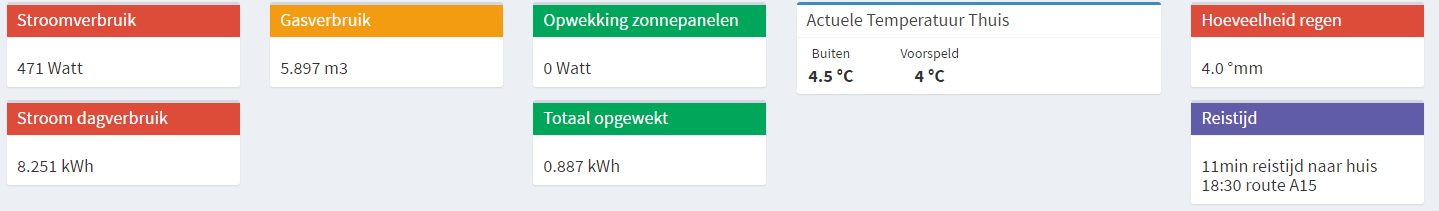

verry nice frontpage. But I have kaku dimmers and these works in steps so when i use the slider the kaku dimmer respons only between 0% and 16% and from 16% it is alway 100% for the light. Is there a way to change this for kaku dimmers?
Re: Yet another frontpage
Posted: Sunday 21 February 2016 20:18
by HansLe
You have to define a new class, f.e. kakudimmers. See how the heaters are defined.

I have tried to implement the gas and electricity also, only i cannot get two values. I want to show the daily usage and the actual usage.
So for electricity i want to use the values: 'CounterToday' and 'Usage'
So i added below in domotics.js
} else if(element.hasClass("actueelverbruik")) {
					that.updateWidget.actueelverbruik(element, result);
				} else if(element.hasClass("totaalverbruik")) {
					that.updateWidget.totaalverbruik(element, result);
And also:
actueelverbruik: function(element, result) {
         var actueelverbruik = result.Usage ;
         // Update the actueelverbruik itself
         element.find(".datavalue" ).html(actueelverbruik);
         // Also do generic updating
         this.generic(element, result);
	  totaalverbruik: function(element, result) {
         var totaalverbruik = result.CounterToday ;
         // Update the totaalverbruik itself
         element.find(".datavalue" ).html(totaalverbruik);
This is working, if i add for example actueel usage like below:
<div class="col col-md-4 col-sm-4 col-xs-2">
               <div class="box actueelverbruik" data-domoticz-id="26" data-status="true"">
                    <div class="box-header box-solid box-info with-border bg-red ">
                        <h3 class="box-title">Actueel verbruik</h3>
                     </div><!-- /.box-header> -->
                       <h4><div class="box-body datavalue">...</div></h4>
                       <!-- /.box-body -->
                 </div><!-- /.box -->
               </div><!-- /.col -->
I get
If i change this code in:
               <div class="box totaalverbruik" data-domoticz-id="26" data-status="true"">
                        <h3 class="box-title">Totaal verbruik</h3>
                       <!-- /.box-body -->
I get
If i place both boxes like:
                       <!-- /.box-body -->
                       <!-- /.box-body -->
I get:
So it shows only the actual usage in both boxes... i am starring at it... but i cannot find it. Hope someone can see what i am doing wrong!

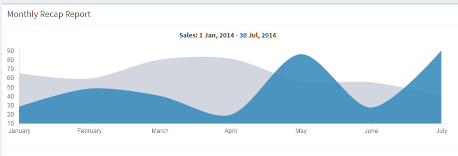

Now starting to implement traffic information and some other iframe stuff like google calendar and squeezebox.
Has anyone sees the AdminLTE2 interface, it would be awesome if you can show the certain graphics like powerconsumption like in this example
See https://almsaeedstudio.com/themes/AdminLTE/index2.html

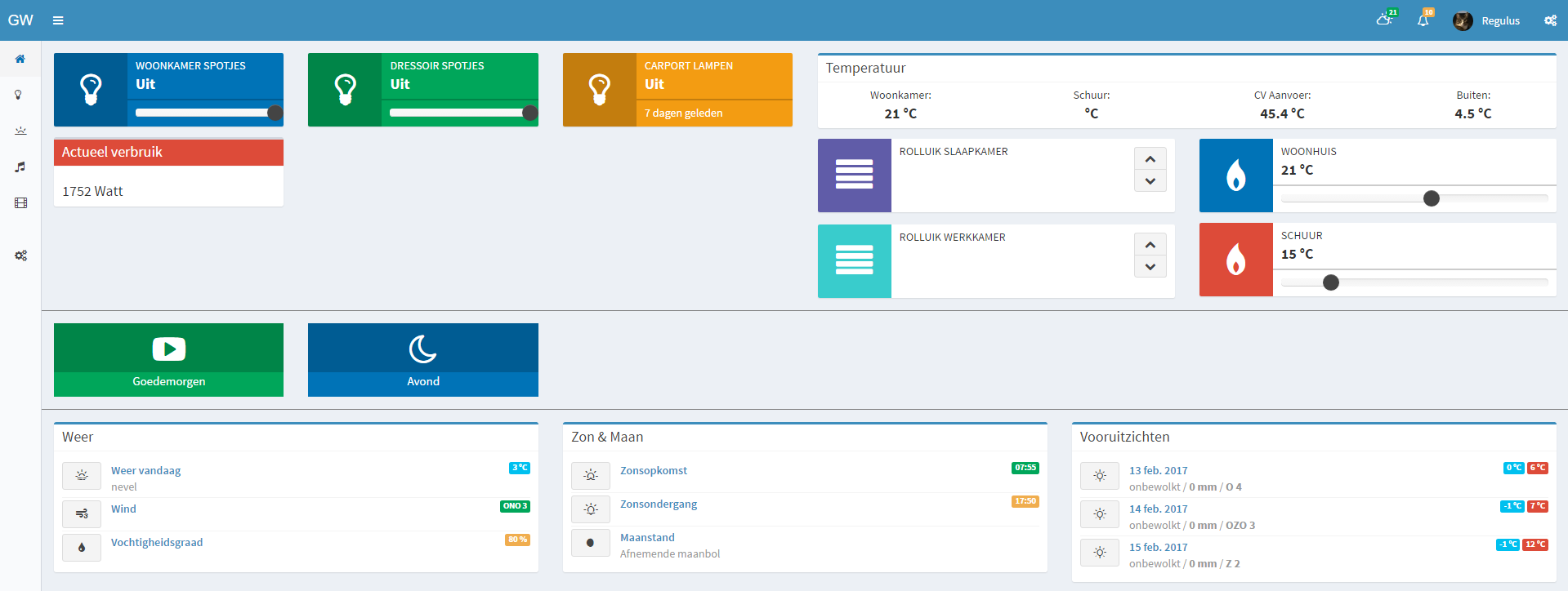

its verry nice, i have a tablet on the livingroom with this frontpage, my girlfriend likes it ;)
would be nice if there are people who can make extra things in. such as current temp a thermostat. as in my living room and barn.
attached a few pictures
