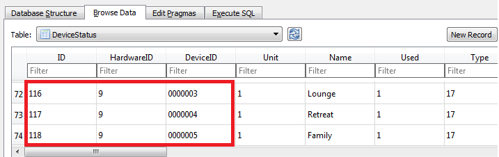

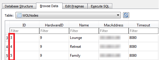

From a logic point of view, the "482" is an invalid ID for one reason or another (this is the 'idx' that you see on the 'Devices' page, do you actually have that many devices???). The Kodi code uses the the DeviceID that matches that index to look into the WOL device table for connection details (I copied the pattern set for 'ping' devices). As shown here:
I used sqlitebowser to check (a backup of) the database. The error you are seeing is a failure of that mapping.
If you still have the error can you show me the relevant details of those two tables?
