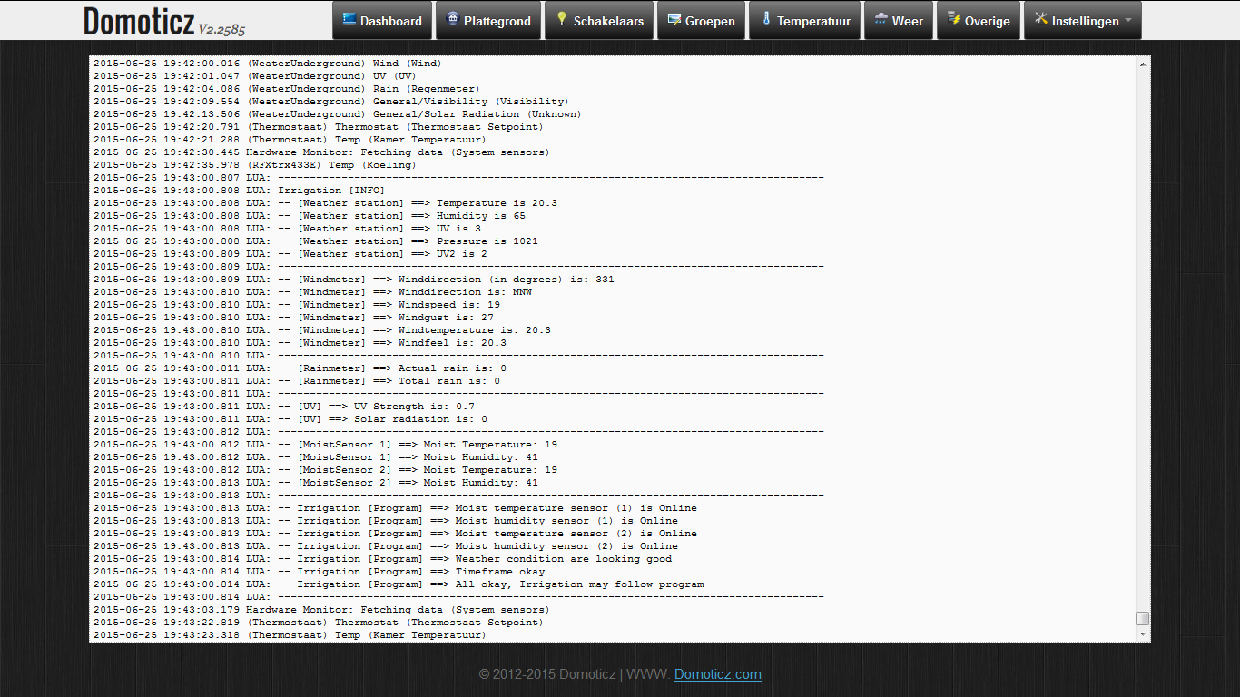

For those who are interested and curious about what i'm upto regarding the script.
It's far from done but the first part is almost ready.
It's a copy and past from several scripts like, scrapping the weather data from weatherundeground, Flipstorm script (still need to implant) and some other snippets found on the internet.
I'm not a coder so it's a lot of trial and error ;)
First preview is ready.
This part of the script scraps the weather data and moist sensor data with a lot of user variables inorder to give the irrigation program a Go or NoGo

Second preview...
Got i bit closer to the end result.
Build in a manual override, improved value checks and improved the Go or No Go and added a desired time of day.
Now i have to build in a desired max run cycle with checks and overrides.
Fun stuff that lua... Never worked with it.

		print("Irrigation [INFO]");
		print("-- [Weather station] ==> Temperature is " .. sWeatherTemp .. " ");
		print("-- [Weather station] ==> Humidity is " .. sWeatherHumidity .. " ");
		print("-- [Weather station] ==> UV is " .. sWeatherUV .. " ");
		print("-- [Weather station] ==> Pressure is " .. sWeatherPressure .. " ");
		print("-- [Weather station] ==> UV2 is " .. sWeatherUV2 .. " ");
	    print("--------------------------------------------------------------------------------------")
-- Windmeter data:
sWindDirectionDegrees, sWindDirection, sWindSpeed, sWindGust, sWindTemperature, sWindFeel = otherdevices_svalues[wind]:match("([^;]+);([^;]+);([^;]+);([^;]+);([^;]+);([^;]+)")
sWindDirectionDegrees = tonumber(sWindDirectionDegrees);
sWindDirection = (sWindDirection);
sWindSpeed = tonumber(sWindSpeed);
sWindGust = tonumber(sWindGust);
sWindTemperature = tonumber(sWindTemperature);
sWindFeel = tonumber(sWindFeel);
	if logging >= 1 then
		print("-- [Windmeter] ==> Winddirection (in degrees) is: " .. sWindDirectionDegrees .. " ");
		print("-- [Windmeter] ==> Winddirection is: " .. sWindDirection .. " ");
		print("-- [Windmeter] ==> Windspeed is: " .. sWindSpeed .. " ");
		print("-- [Windmeter] ==> Windgust is: " .. sWindGust .. " ");
		print("-- [Windmeter] ==> Windtemperature is: " .. sWindTemperature .. " ");
		print("-- [Windmeter] ==> Windfeel is: " .. sWindFeel .. " ");
-- Rainmeter data:
sRainmeterCurrent, sRainmeterTotal = otherdevices_svalues[rain]:match("([^;]+);([^;]+)")
sRainmeterCurrent = tonumber(sRainmeterCurrent);
sRainmeterTotal = tonumber(sRainmeterTotal);
		print("-- [Rainmeter] ==> Actual rain is: " .. sRainmeterCurrent .. " ");
		print("-- [Rainmeter] ==> Total rain is: " .. sRainmeterTotal .. " ");
-- UV data:
sUV, sSolar = otherdevices_svalues[uv]:match("([^;]+);([^;]+)")
sUV = tonumber(sUV);
sSolar = tonumber(sSolar);
		print("-- [UV] ==> UV Strength is: " .. sUV .." ");
		print("-- [UV] ==> Solar radiation is: " .. sSolar .." ");
-- Scrapping Temparature and moist humidity from moist sensor
-- Moist Sensor 1 data:
    smoistsensorTemp, smoistsensorHumidity = otherdevices_svalues[moistsensor1]:match("([^;]+);([^;]+);([^;]+)")
    smoistsensorTemp = tonumber(smoistsensorTemp);
    smoistsensorHumidity = tonumber(smoistsensorHumidity);
		print("-- [MoistSensor 1] ==> Moist Temperature: " .. smoistsensorTemp .. " ");
		print("-- [MoistSensor 1] ==> Moist Humidity: " .. smoistsensorHumidity .. " ");
-- Moist Sensor 2 data:
    smoistsensor2Temp, smoistsensor2Humidity = otherdevices_svalues[moistsensor2]:match("([^;]+);([^;]+);([^;]+)")
    smoistsensor2Temp = tonumber(smoistsensor2Temp);
    smoistsensor2Humidity = tonumber(smoistsensor2Humidity);
		print("-- [MoistSensor 2] ==> Moist Temperature: " .. smoistsensor2Temp .. " ");
		print("-- [MoistSensor 2] ==> Moist Humidity: " .. smoistsensor2Humidity .. " ");
-- Moist Sensor online check
-- Moist Sensor 1:
-- check if the moist sensor 1 is online
if (smoistsensorTemp == 0 or smoistsensorTemp == nil) then
    print('Irrigation [MoistSensor 1 ERROR] ==> Moist Sensor 1 reports Temp is 0 or nil. Skipping Irrigation')
	if(uservariables['VarMoistCon'] == 1) then
	commandArray['Variable:VarMoistCon']= '0'
    return commandArray
		print("-- Irrigation [Program] ==> Moist temperature sensor (1) is Online");
	if(uservariables['VarMoistCon'] == 0) then
	commandArray['Variable:VarMoistCon']= '1'
if (smoistsensorHumidity == 0 or smoistsensorHumidity == nil) then
    print('Irrigation [MoistSensor 1 ERROR] ==> Moist Sensor 1 reports Humidity is 0 or nil. Skipping Irrigation')
    return commandArray
		print("-- Irrigation [Program] ==> Moist humidity sensor (1) is Online");
-- Moist Sensor 2:
-- check if the moist sensor 2 is online
if (smoistsensor2Temp == 0 or smoistsensor2Temp == nil) then
    print('Irrigation [MoistSensor 2 ERROR] ==> Moist Sensor 2 reports Temp is 0 or nil. Skipping Irrigation')
    return commandArray
		print("-- Irrigation [Program] ==> Moist temperature sensor (2) is Online");
if (smoistsensor2Humidity == 0 or smoistsensor2Humidity == nil) then
    print('Irrigation [MoistSensor 2 ERROR] ==> Moist Sensor 2 reports Humidity is 0 or nil. Skipping Irrigation')
    return commandArray
		print("-- Irrigation [Program] ==> Moist humidity sensor (2) is Online");
-- checking weather conditions so irrigation may proceed
if day == VarDay1 or day == VarDay2 or day == VarDay3 or day == VarDay4 or day == VarDay5 or day == VarDay6 or day == VarDay7 or
   month == VarMonth1 or month == VarMonth2	or month == VarMonth3 or month == VarMonth4 or month == VarMonth5 or month == VarMonth6 or month == VarMonth7 or month == VarMonth8 or month == VarMonth9 or month == VarMonth10 or month == VarMonth11 or month == VarMonth12
	and smoistsensorTemp >= tonumber (VarTarTempMin)
	--and smoistsensorTemp <= tonumber (VarTarTempMax)
	--and smoistsensorHumidity <= tonumber (VarTarHum)
	--and sRainmeterCurrent == tonumber (RainCurrent)
	--and sWeatherTemp >= tonumber (WeatherTempMin)
	--and sWeatherTemp <= tonumber (WeatherTempMax)
	--and sUV <= tonumber (UV)
	--and sWindSpeed <= tonumber (WindSpeed)
	--and sWindGust <= tonumber (WindGust)
then
		print("-- Irrigation [Program] ==> Weather condition are looking good");
	if(uservariables['VarWeatherCon'] == 0) then
	print("-- Irrigation [Program] ==> Weather condition set Okay");
	commandArray['Variable:VarWeatherCon']= '1'
		print("-- Irrigation [Program] ==> Weather condition aren't looking good");
	if(uservariables['VarWeatherCon'] == 1) then
	print("-- Irrigation [Program] ==> Weather condition set False");
	commandArray['Variable:VarWeatherCon']= '0'
-- checking time of the day so irrigation may proceed
if (timeofday['Sunrise']) and (uservariables['VarTimeOfDayCurrent'] ~= 0) then
commandArray['Variable:VarTimeOfDayCurrent']= '0'
print("-- Irrigation [Program] ==> Time set to Morning")
if (time.hour >= 12) and (time.hour <= 17) and (uservariables['VarTimeOfDayCurrent'] ~= 1) then
commandArray['Variable:VarTimeOfDayCurrent']= '1'
print("-- Irrigation [Program] ==>  Time set to Afternoon")
if (time.hour >= 17) and (time.hour <= 20) and (uservariables['VarTimeOfDayCurrent'] ~= 2) then
commandArray['Variable:VarTimeOfDayCurrent']= '2'
print("-- Irrigation [Program] ==>  Time set to Evening")
if (time.hour >= 20) and (uservariables['VarTimeOfDayCurrent'] ~= 3) then
commandArray['Variable:VarTimeOfDayCurrent']= '3'
print("-- Irrigation [Program] ==>  Time set to Night")
if (uservariables['VarTimeOfDayCurrent']) == tonumber (VarTimeOfDay) then
print("-- Irrigation [Program] ==> Timeframe okay")
if (uservariables['VarTimeCon']) == 0 then
commandArray['Variable:VarTimeCon']= '1'
print("-- Irrigation [Program] ==> Awaiting for the right Timeframe")
if (uservariables['VarTimeCon']) == 1 then
commandArray['Variable:VarTimeCon']= '0'
-- Processing data into a usable yes or nogo for irrigation
		and (uservariables['VarWeatherCon']) == 1
		and (uservariables['VarMoistCon']) == 1
		--and (uservariables['VarMayFollowProgram']) == 0
		and (uservariables['VarFollowsProgram']) == 0
		and (uservariables['VarManOverride']) == 0
	then
		print("-- Irrigation [Program] ==> All okay, Irrigation may follow program")
		if (uservariables['VarMayFollowProgram']) == 0 then
		commandArray['Variable:VarMayFollowProgram']= '1'
		print("-- Irrigation [Program] ==> All ain't okay, Irrigation may not follow program")
	if (uservariables['VarMayFollowProgram']) == 1 then
	commandArray['Variable:VarMayFollowProgram']= '0'
	if (uservariables['VarManOverride']) == 1
	then
		print("-- Irrigation [Program] ==> Irrigation set to manual, programm stopped")
		if (uservariables['VarFollowsProgram']) == 1 then
		commandArray['Variable:VarFollowsProgram']= '0'

How long does the water keeps flowing if activated by the script? I don't know if those washing machine valves can handle being turned on for an hour or so. I think they will get quite warm.
Normally in a washing machine they are only operated for 2 minutes or so.
Siewert308SW
Posts: 290
Joined: Monday 29 December 2014 15:47
Domoticz version: Stable
Re: [DIY] Garden irrigation and learning project
Post by Siewert308SW »
ThinkPad wrote:Nice project :)
Script aint ready yet so i can not test it yet.
For i only have a small script which looks at the the moist humidity and triggers when water is required.
Holiday time so i'm at the camping for 4 weeks.
Won't be writing all day, just enjoying the weather and beer :D
I don't know how long such a valve can be on as it was raining last week and this weekend so no irrigation required.
Only had it ON two times to see how long it took to get to a certain humidity level.
Which took 50min to get from 45% to 85%.
But i guess it gets a bit of cooling when the water flows by the membrane.
Lucky it's just a 6euro part so easily replaced when it dies ;)
The script version i got here is different from the one i posted earlier.
It's far from ready but hope to finish it soon.
A Preview of the current script you will find below.
- The scripts scraps the weather conditions from WeatherUnderground.
- For Dutch users i also inserted buienradar rain forecast for 6/12/24hr
- Also the scripts checks if the Moist sensors are online and sending the right values.
- It also checks if the right TimeOfTheDay is correct which you have to set in the script.
- Same counts for which days of week and months you want to be able to irrigate.
- You also can set your desired DayTime like morning, evening or night
- The script has a manual override to stop irrigation when needed
- When a irrigation cycle has completed it will trigger a override which will reset when your TimeFrame is correct again.
So for example you set irrigation ON on Monday and Thursday and the irrigation has completed on Monday then it won't trigger again on Monday until your on Thursday even if the all the targeted conditions say you must irrigate.
Further more the irrigation will be stopped when your desired humidity is reached within your desired Maximum Irrigation RunTime.
The RunTime when the pump is ON can be set manually i have it set to 60min.
So if the humidity target is reached with in the hour then the irrigation will stop.
But when the hour expires and the humidity target hasn't been reached then the irrigation will also stop.
Only the script won't stop when the weather conditions are going from a OKAY to a FALSE.
When the irrigation program has been started while the weather target conditions are good and suddenly the weather condition changes the irrigation will finish it cycle.
So it only stops when the humidity target or MaxRunTime has been exceeded.
I'm not a programmer so the script aint the cleanest but for me it will work and does the job... :D
As mentioned earlier, it's not finished yet.
		print("Irrigation [PROGRAM - Weather Conditions]");
		print("-- Irrigation ==> [WeatherStation] - Temperature is " .. sWeatherTemp .. " ");
		print("-- Irrigation ==> [WeatherStation] - Humidity is " .. sWeatherHumidity .. " ");
		print("-- Irrigation ==> [WeatherStation] - UV is " .. sWeatherUV .. " ");
		print("-- Irrigation ==> [WeatherStation] - Pressure is " .. sWeatherPressure .. " ");
		print("-- Irrigation ==> [WeatherStation] - UV2 is " .. sWeatherUV2 .. " ");
-- Windmeter data:
		print("-- Irrigation ==> [Windmeter] - Winddirection (in degrees) is: " .. sWindDirectionDegrees .. " ");
		print("-- Irrigation ==> [Windmeter] - Winddirection is: " .. sWindDirection .. " ");
		print("-- Irrigation ==> [Windmeter] - Windspeed is: " .. sWindSpeed .. " ");
		print("-- Irrigation ==> [Windmeter] - Windgust is: " .. sWindGust .. " ");
		print("-- Irrigation ==> [Windmeter] - Windtemperature is: " .. sWindTemperature .. " ");
		print("-- Irrigation ==> [Windmeter] - Windfeel is: " .. sWindFeel .. " ");
-- Rainmeter data:
		print("-- Irrigation ==> [Rainmeter] - Actual rain is: " .. sRainmeterCurrent .. " ");
		print("-- Irrigation ==> [Rainmeter] - Total rain is: " .. sRainmeterTotal .. " ");
-- UV data:
		print("-- Irrigation ==> [UV] - UV Strength is: " .. sUV .." ");
		print("-- Irrigation ==> [UV] - Solar radiation is: " .. sSolar .." ");
if  sRainmeterCurrent >= tonumber (RainCurrent)
	and sUV <= tonumber (UVMax)
then
		print("-- Irrigation ==> [Weather] - Weather conditions are looking good and ready for irrigation");
		print("-- Irrigation [Info] ==> Weather conditions aren't looking good");
-- Moist Sensor data:
    smoistsensorTemp, smoistsensorHumidity = otherdevices_svalues[MoistSensor]:match("([^;]+);([^;]+);([^;]+)")
		print("Irrigation [PROGRAM - Moist Sensor and Moist Conditions]");
		print("-- Irrigation ==> [MoistSensor] - Moist Temperature: " .. smoistsensorTemp .. " ");
		print("-- Irrigation ==> [MoistSensor] - Moist Humidity: " .. smoistsensorHumidity .. " ");
    print('-- Irrigation ==> [MoistSensor] - [ERROR] Moist Sensor reports Temp is 0 or nil. Skipping Irrigation')
	if(uservariables['VarMoistOnline'] == 1) then
	commandArray['Variable:VarMoistOnline']= '0'
	if(uservariables['VarMoistOnline'] == 0) then
	commandArray['Variable:VarMoistOnline']= '1'
if (smoistsensorHumidity <= 6 or smoistsensorHumidity >= 99 or smoistsensorHumidity == nil) then
    print('-- Irrigation ==> [MoistSensor] - [Error] ==> Moist Sensor reports wrong Humidity values. Skipping Irrigation')
	if(uservariables['VarMoistOnlineHum'] == 1) then
	commandArray['Variable:VarMoistOnlineHum']= '0'
	if(uservariables['VarMoistOnlineHum'] == 0) then
	commandArray['Variable:VarMoistOnlineHum']= '1'
-- checking moist conditions
if 	smoistsensorTemp >= tonumber (VarTarTempMin)
then
		print("-- Irrigation ==> [MoistSensor] - Moist Temp conditions are fine for irrigation");
	if(uservariables['VarMoistConTemp'] == 0) then
	commandArray['Variable:VarMoistConTemp']= '1'
	print("-- Irrigation ==> [MoistSensor] - Moist Temp conditions aren't good enough for irrigation");
	if(uservariables['VarMoistConTemp'] == 1) then
	commandArray['Variable:VarMoistConTemp']= '0'
if smoistsensorHumidity <= tonumber (VarTarHum)
then
		print("-- Irrigation ==> [MoistSensor] - Moist humidity conditions are fine for irrigation");
	if(uservariables['VarMoistConHum'] == 0) then
	commandArray['Variable:VarMoistConHum']= '1'
	print("-- Irrigation ==> [MoistSensor] - Moist humidity conditions aren to high, no irrigation required");
	if(uservariables['VarMoistConHum'] == 1) then
	commandArray['Variable:VarMoistConHum']= '0'

Here a updated version for dutch users.
Now i integrated the IsItGonnaRain script by Hans van der Heijden into mine.
So when there is rain expected within 24hr and more then you set in the settings then the Irrigation program is set to standby.
Also when the irrigation is running and there is more rain expected then you set in the settings then the irrigation will be stopped.
I also changed the Soil Moist Humidity trigger.
Irrigation will now be activated when a minimum humidity target is reached and irrigation will stop when the maximum is reached.

	result = false
	if VarIsPump and counter >= 1 then
		result = true
	elseif not VarIsPump and math.abs(counter) >= VarMaxRunTime_off then
		result = true
	return result
-- Start irrigation
function on_off(VarIsPump)
	update_allowed = may_update(VarIsPump)
	info('Irrigation Pump = [' .. otherdevices[VarPump] .. ']')
	if update_allowed then
		if otherdevices[VarPump] == 'Off' and VarIsPump then
 			commandArray[VarPump]='On'
			commandArray['Variable:VarProgramRun']= '1'
		elseif (otherdevices[VarPump] == 'On' and not VarIsPump) then
 			commandArray[VarPump]='Off'
			commandArray['Variable:VarProgramOverride']= '1'
-- Is Irrigation  On.
function is_VarFollowsProgram_aan()
	result = false
	result = (uservariables['VarFollowsProgram'] == 1)
    return result
-- Starting Irrigation
if validate() then
	on_off(is_VarFollowsProgram_aan())
	if logging >= 1 and (uservariables['VarMayFollowProgram']) == 0
		and (uservariables['VarProgramOverride']) == 0
	then
		print("-- Irrigation [Standby] ==> Irrigation Program on Standby")
	if logging >= 1 and (uservariables['VarMayFollowProgram']) == 1
		and (uservariables['VarProgramOverride']) == 1
	then
		print("-- Irrigation [Standby] ==> Already Irrigated, Irrigation Program on Standby and awaiting new cycle")
return commandArray
