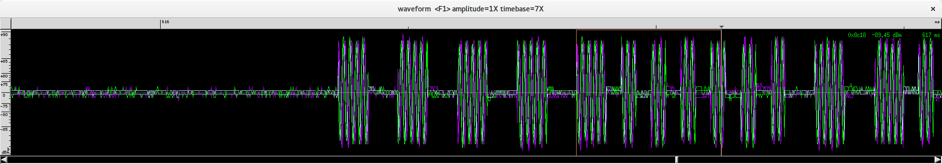

Well, this tool is really great ! :)
Tool say's it's OOK modulated (ok, It was looking ASK to me, but I'm really not an RF expert) and manchester encoded.
Frequency is set to 868.3, If I set it to 868.4 I get nothing. (So I was probably wrong with my 868403755 value)
If I set PPM to 60, I get nothing. (ok this is probably not necessary anyway).
Here are some data I get playing with my Deltia 3 areas switching between ECO / Confort mode on my 3rd zone :
[00] {590} 55 7f 5d a4 ca 95 32 ad d5 15 7e 28 7f c0 51 2d 9a b5 66 a9 15 75 40 eb c0 1f d7 69 32 a5 4c ab 75 45 5f 8a 1f f0 14 4b 66 ad 59 aa 45 5d 50 3a f0 07 f5 da 4c a9 53 2a dd 51 57 e2 87 fc 05 12 d9 ab 56 6a 91 57 54 0e bc 00
[00] {590} 55 7f 5d a4 ca 95 32 ad 95 0a 81 f3 80 3f ae d2 65 4a 99 56 ca 85 40 f9 c0 1f d7 69 32 a5 4c ab 65 42 a0 7c e0 0f eb b4 99 52 a6 55 b2 a1 50 3e 70 07 f5 da 4c a9 53 2a d9 50 a8 1f 38 03 fa ed 26 54 a9 95 6c a8 54 0f 9c 00
[00] {590} 55 7f 5d a4 ca d5 32 ad d5 55 7e 27 80 3f ae d2 65 6a 99 56 ea aa bf 13 c0 1f d7 69 32 b5 4c ab 75 55 5f 89 e0 0f eb b4 99 5a a6 55 ba aa af c4 f0 07 f5 da 4c ad 53 2a dd 55 57 e2 78 03 fa ed 26 56 a9 95 6e aa ab f1 3c 00
[00] {590} 55 7f 5d a4 ca 95 32 ad d5 55 7e 08 7f c0 51 2d 9a b5 66 a9 15 55 40 fb c0 1f d7 69 32 a5 4c ab 75 55 5f 82 1f f0 14 4b 66 ad 59 aa 45 55 50 3e f0 07 f5 da 4c a9 53 2a dd 55 57 e0 87 fc 05 12 d9 ab 56 6a 91 55 54 0f bc 00
[00] {590} 55 7f 5d a4 ca d5 32 ad 95 0a 81 dc 7f c0 51 2d 9a 95 66 a9 35 7a bf 11 c0 1f d7 69 32 b5 4c ab 65 42 a0 77 1f f0 14 4b 66 a5 59 aa 4d 5e af c4 70 07 f5 da 4c ad 53 2a d9 50 a8 1d c7 fc 05 12 d9 a9 56 6a 93 57 ab f1 1c 00
Playing with this data in Excel, some line are strictly identical !??? I thought X2D was using a rolling code !???
I'm starting to think that X2D is not that secured as I tought !??
Some lines are not exactly identical to others, but I think the Deltia was sending order to another zone.
OK this data may be nothing, but I must admit it looks rather nice.

Messages seem's to be exactly the same than yesterday.
If I compare with results from ervplecter, data seem's different, by size and content. (I wonder if it's data has really been Manchester decoded ?)
Converting Hexa to binary in excel (copy/past lines above, then convert spaces to columns, remove weird caracters by copy/past + replace to nothing, then apply the following formula french excel : =HEXBIN(EPURAGE(I6);8) )
55 7F give : 01010101 0111111 I really like those binary values at frame start :)
Between 1rst message and second message: some values are exactly the same, some are inverted (00101001 --> 11010110), some are nearly the same (00101001 --> 00111001).
I actually don't really understand why we have 2 frames, but probably second one should help to validate the first one ? (or the contrary) Or is it for something like repetitor or something else ?
In Area 3, Comparing ECO->Comfort vs Comfort->ECO, I really have few bits changing only 1 / bytes that are moving.
2nd message seem's to never change in an Area, so it's probably something like a Mask to validate 1rst message
In Area 1, Comparing ECO->Comfort vs Comfort->ECO, I have far more bits moving. I wonder if this assomething to do with number of heaters in Area ? (In Area 1 : 4 Heaters, In Area 2 : 3 heaters, In Area 3 : 1 heater)
In Area 2, Comparing ECO->Comfort vs Comfort->ECO,Few bits are moving, same columns as in Area3 (only 1 exception).
I'll have to understand why there is such a difference between Area 1 and other areas.
If someone could do the same tests, it will be interesting to compare and could help to identify some bytes. (House Address for exemple)
SixK

A message repeats about 26 times the same frame, in order to let a chance for the receiver ti catch one of those. The rolling code is mainly use for alarm applications.
Envoyé de mon MotoG3 en utilisant Tapatalk

A message start with 10 zeros (ie 10 long pulses). A frame start with 1111110 and end with 0xFE. And you have about 26 frames per message.

Last trick: when decoding a frame, if you have this sequence 111110x remove the 0 in order to have 11111x. With this last trick, which prevent from false 0xFE decoding, I can compute the right crc: not(sum bytes[0,len-2])+1

@poloalexis, to sum up what you says, data I get are not X2D data ?
I seen you use biphase mark decoding, RTL_433 use Manchester decoding.
Are you sure about bi-phase mark use ?
Manchester seem's ok since 55 7f appear to me as a comon pattern for preambule+sync word.
1rst message as data + 2nd message as mask or configuration seem's ok too.
75 bits packet seem's ok too. I think I read this packet size somewhere else in an X2D description.
Can you past data you get ?
If we want to command our heaters, decoding X2D protocol is probably not necessary, we juste need to send same data as we got using the same coding we used to decode.
SixK

If you look at raw message, On start, you will see 5 long pulse then 6 short pulses.
With Manchester encoding, I would interprete this as :
01 01 01 01 + 01 1 1 1 1 1 1 (I would have said 10 10 10 10 + 10 1 1 1 1 1 1, but rtl_433 says it's 01 01 01 01 + 01 1 1 1 1 1 1)
55 + FF
I didn't seen 10 long pulse in a row in raw message.
What X2D device do you use ? Deltia for heaters or something else ?
SixK

It seems to me that the rtl_433 app is Manchester-decoding the data LSB first, while it seems that the actual order should be MSB first. Just reverse each data byte and you'll find the same preamble and frame delimiter reported by poloalexis. Still, I think that further coding is required for this app to remove the zero insertions to avoid decoding false frame delimiters and get the actual frames.
