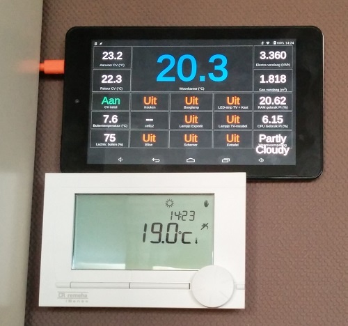

Here is how it looks in real life: Image
I also can turn the screen on and off with Domoticz :D
More info: http://domoticz.com/forum/viewtopic.php?f=28&t=4733

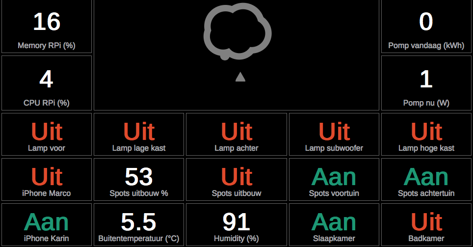

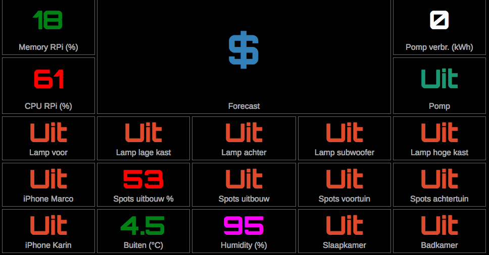

I've been fiddling with the code a bit and have this at the moment (see image). Instead of using words in the Forecast-cell (like: rain, snow, sun), I'd like to use the skycons (http://darkskyapp.github.io/skycons/). But it isn't very easy to do. Maybe somebody can help me/us out here?
Oh, and one other question: how can I let the cells in this page turn from black to orange / light red / dark red / etc. when a certain value in a certain cell hits a certain level?
Schermafbeelding 2015-01-05 om 08.14.05.png (79.94 KiB) Viewed 11811 times

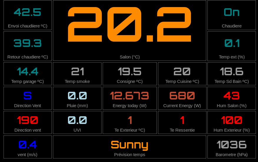

Hi guys, i think this is a very nice option for tablet users. I thought the design needed some quick fixes, so i spent a few hours editing some things. I used ThinkPad's code to start from.
What i did
- Tried to get it in the same theme as my main-theme
- Responsive Design (scales on every screensize)
- Link back to DomoticZ (don't forget to change your IP)
How do i get it?
You can test the html file over here and download it over here
Just paste the 2 files in your WWW folder. And visit http://yourip:8080/frontpage.html

I'm trying to get the skycons images in, but it doesn't seem to work. I made a completely stripped page, and added all code from the frontpage.html in bit by bit, and when I add the piece of code from 'RefreshData()' (etc) the skycons become invisible. The code can be found here: http://pastebin.com/jxn6NW8V
The $ marks the place where I want the skycons (and you can find the $ in the code where the 'Cloudy' is being set to <canvas id..... etc.
I really hope somebody can help me out. Thanks in advance!

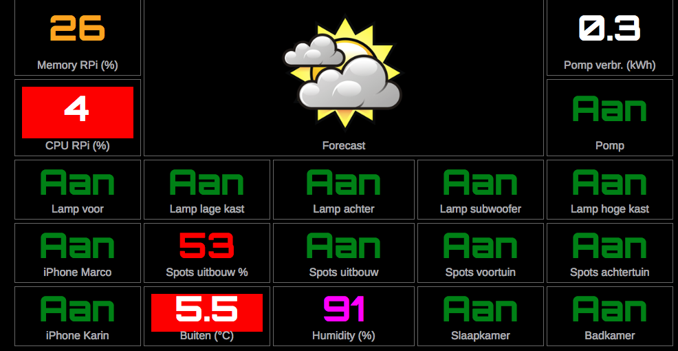

I switched to static images (couldn't find nice animated images) and this is what I have so far. It needs some tweaking, but now it's starting to look like what I wanted.
Code:
frontpage.html -> http://pastebin.com/RnvaayUS
frontpage.css -> http://pastebin.com/wFA8R8jY
Edit:
Today I managed to get the background color to change when the sun sets and when the sun rises. It uses the virtual switch 'IsDark' that I use. And when the outdoor temperature gets below 0, the cell color of the outside temperature gets blue :)

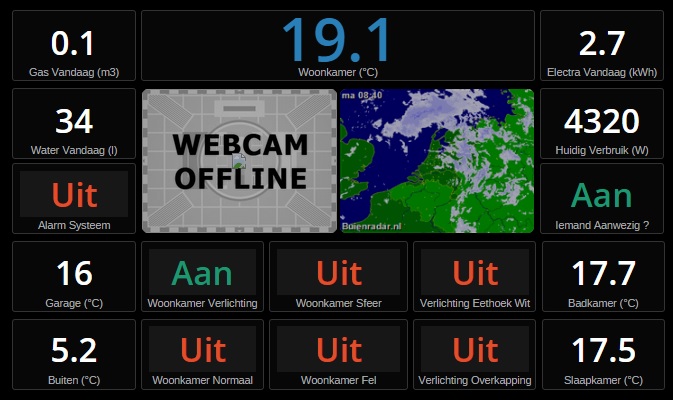

@Slorf I just added two pictures in the div. They refresh every 0.5 sec. I didn't try iframes yet.
I changed the code so you cannot switch protected switches anymore.

bizziebis
Posts: 182
Joined: Saturday 19 October 2013 14:00
Domoticz version: 3.8805
Post by bizziebis »
http://pastebin.com/GpUvApEL
What I also changed:
* Add grey background when item is a switch and not protected
* Protected switches are not switchable
* Popup when pressing a protected switch
* Frontpage is now a webapp when you save it to homescreen on Android/IOS
* Support for webcam image
* Offline image when webcam is not reachable
* Buienradar as image also possible
So if someone want's to add it to their page, feel free to check the code.
