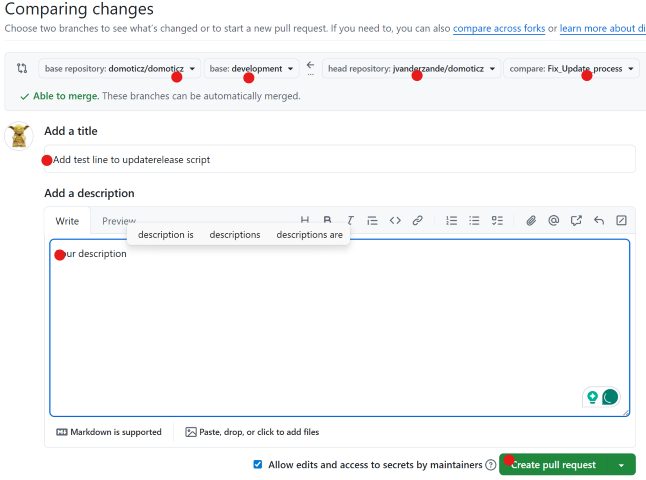

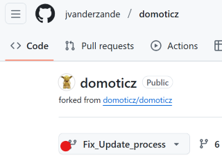

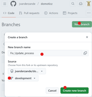

A short description of the pull-request creation process :
1. Fork the original repository you'd like to make updates for.
2. Go into your own forked Repository and copy the Branch you like to make an update for into a new Branch, so in this case select the Development branch: 3. Go to the main page and select the newly created Branch. 4. Update the file(s) that need modification and commit the change.
5. On the main page you now see the Contribute option. Click Contribute & Open Pull Request: 6. Add title & Description
Check the Target Repo : Domoticz/Domiticz - Development
Check source Repo: YOU/domoticz - Fix_Update_Process
Click on "Create Pull Request" That's it.
The reason for creating a new Branch is that this allows it to be deleted after the PR is processed, which is an option when merge is done.
On top of that, you shouldn't update the Development branch itself as that will sync with the updates done in Domoticz/Domoticz and else could create conflicts when you want to update you forked version.
