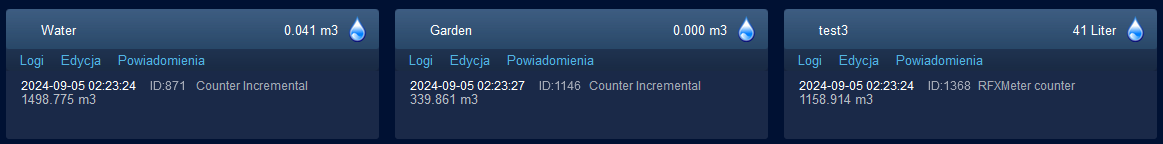

It seems to work (thank you very much FlyingDomotic). I have one more question. Why do I get the result in liters and not m3? Is there any way to change this?

FlyingDomotic
Posts: 475
Re: Script subtracting measurements from two water meters
Post by FlyingDomotic »
Differences comes from different counter types: Water and Garden are "(incremental) counters" while Test3 is "RFXmeter counter". If you wish having the same format, changing Test3 to "Counter" (not incremental) may help (I didn't test it).

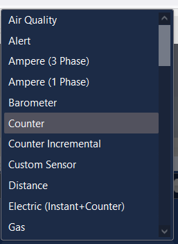

This doesn't help, because the RFXmeter counter is a counter selected from a list. As in the screenshot below.

Maciek90 wrote: Saturday 07 September 2024 20:37 This doesn't help, because the RFXmeter counter is a counter selected from a list. As in the screenshot below.
What's the issue? Just create d dummy device with "Counter type", select it in "Utility" tab, change change type to "water" and validate.
