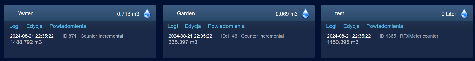

I have two water meters at home; one main for the whole house and garden, and a separate one just for the garden. I want to calculate the difference between the readings of the main water meter and the one for the garden. I tried to write something using ChatGPT, but it didn't quite work out well. I added the RFX Meter Counter device. The overall difference is counted correctly, but the daily difference is not updated, it is always 0 like on screen below. Could someone help improve the script below?
    active = true,
        devices = { 'Water', 'Garden' }
    logging = {
        level = domoticz.LOG_DEBUG,
        marker = "Water Counter Script"
        local count1 = domoticz.devices('Water').counter
        local count2 = domoticz.devices('Garden').counter
        local resultCounter = domoticz.devices('test')
        local dailyCount1 = domoticz.devices('Water').counterToday
        local dailyCount2 = domoticz.devices('Garden').counterToday
        domoticz.log('Water: ' .. tostring(count1), domoticz.LOG_DEBUG)
        domoticz.log('Garden: ' .. tostring(count2), domoticz.LOG_DEBUG)
        domoticz.log('Daily Water: ' .. tostring(dailyCount1), domoticz.LOG_DEBUG)
        domoticz.log('Daily Garden: ' .. tostring(dailyCount2), domoticz.LOG_DEBUG)
        if count1 ~= nil and count2 ~= nil then
            local totalDifference = count1 - count2
            local dailyDifference = dailyCount1 - dailyCount2
            domoticz.log('Total difference: ' .. tostring(totalDifference), domoticz.LOG_DEBUG)
            domoticz.log('Daily difference: ' .. tostring(dailyDifference), domoticz.LOG_DEBUG)
            resultCounter.updateCounter(totalDifference)
            domoticz.log('One device has nil value', domoticz.LOG_ERROR)
Bez tytułu.png (62.28 KiB) Viewed 2282 times

Log looks good, like below
2024-08-21 22:27:52.274 dzVents: Handling events for: "Garden", value: "18446744073709549768"
2024-08-21 22:27:52.274 dzVents: Water Counter Script: ------ Start internal script: Water counter: Device: "Garden (Water)", Index: 1146
2024-08-21 22:27:52.275 dzVents: Debug: Water Counter Script: Start script: Garden
2024-08-21 22:27:52.275 dzVents: Debug: Water Counter Script: Processing device-adapter for Water: Counter device adapter
2024-08-21 22:27:52.275 dzVents: Debug: Water Counter Script: Processing device-adapter for test: Counter device adapter
2024-08-21 22:27:52.276 dzVents: Debug: Water Counter Script: Water: 1488.783
2024-08-21 22:27:52.276 dzVents: Debug: Water Counter Script: Garden: 338.397
2024-08-21 22:27:52.276 dzVents: Debug: Water Counter Script: Daily Water: 0.704
2024-08-21 22:27:52.276 dzVents: Debug: Water Counter Script: Daily Garden: 0.069
2024-08-21 22:27:52.276 dzVents: Debug: Water Counter Script: Total difference: 1150.386
2024-08-21 22:27:52.276 dzVents: Debug: Water Counter Script: Daily difference: 0.635
2024-08-21 22:27:52.276 dzVents: Water Counter Script: ------ Finished Water counter

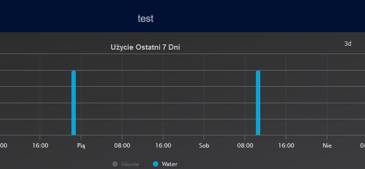

Counter change during the day. Now it looks like below. I don't know why the daily counter shows 0 liters all the time, even though it calculates daily consumption in the logs
Bez tytułu2.png (63.22 KiB) Viewed 2260 times

You are using two incremental counters to calculate the difference and you are then updating a normal counter "test" with that value.
So the normal counter will show only the difference between the two incremental counters and therefore will go up and down all the time during the day. The daily value as calculated by the nightly switchover routine will then be the difference between the minimum and the maximum value of the day on that normal counter. (which I would expect to be small but not zero, since the minimum of the day will be the lowest single use of water in the house and the maximum will be the largest single use of water in the house, so the difference might be a shower or toilet flush quantity minus a quick handwash quantity, so guess daily value is then 20 or 30 liters or so, 0.02 m3)
You have two options:
1) Also use an incremental counter for the "test" counter.
2) Use a normal counter but before you do an update first read the current value and add the new value to the current value, then update the counter with that new total (taking into account any divider set on that counter).
Posts: 7005

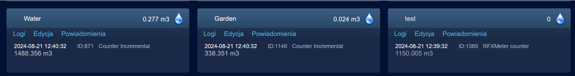

I noticed something else strange. Sometimes the daily value of the test counter shows 1000 liters as in the graph below(Pią is last friday, Sob is last saturday). Any ideas what to correct in the script? I'm sorry, but I'm quite weak in dzVents
Bez tytułu.png (20.66 KiB) Viewed 2111 times

Depending on device type, it may be necessary to multiply data read by some coefficient. Here, that's probably 1000, as very often data is shown in m3, while counted in liter. Try to multiply "Water" and "Garden" by 1000 and see what's happening.

2024-09-01 21:39:31.464 dzVents: Debug: Water Counter Script: Daily difference: 0.449
2024-09-01 21:39:31.464 dzVents: Debug: Water Counter Script: resultCounterToday: 0
2024-09-01 21:39:31.464 dzVents: Debug: Water Counter Script: resultCounter : 1157.726
Domoticz counters have daily values reset to zero every morning at midnight. You don't have to do something special to get it.
However, not increasing continuously a counter makes amazing daily totals ... as you can see ;-)
Just try my proposal for a day or two...
What do you mean specifically? What should I change in the script to implement your suggestion?
