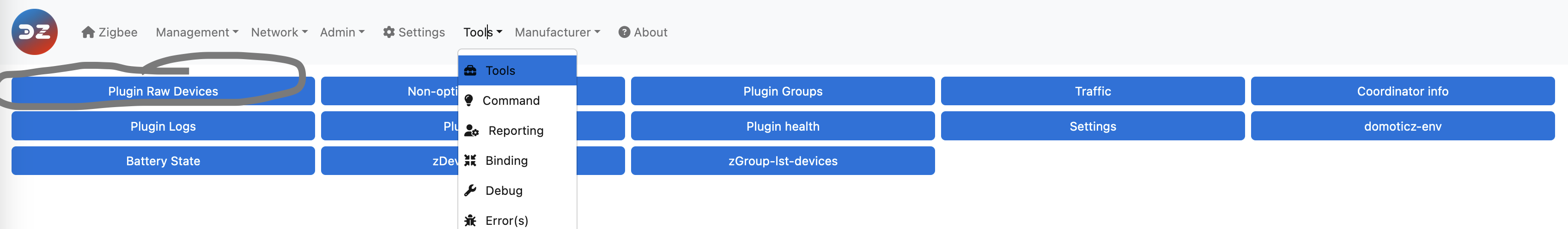

I would need an export.json plugin raw devices information. so I can understand what is wrong with battery

pipiche wrote: Tuesday 31 October 2023 8:13 I would need an export.json plugin raw devices information. so I can understand what is wrong with battery
How do I get this data :?
pipiche
Posts: 2027
Re: Zigbee for domoticz error
Post by pipiche »
Screenshot 2023-10-31 at 20.15.08.png (138.67 KiB) Viewed 2581 times

Ikea trädfri pir, hope this will do, if not let me know.
