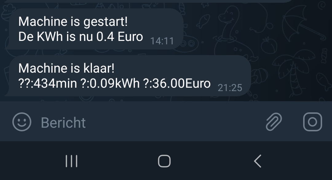

hi hoeby,
The script works without errors, which is nice.
What doesn't work yet is that it doesn't work with the off-peak rate. No problem if it's not possible. I have attached a picture from Telegram.
What is also not correct are the number of watts and the final price, but I still have to adjust that with the share factor
Yours sincerely,
Fred
