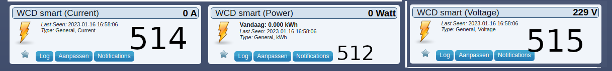

Dear forum members,
I have a zigbee power plug (see photo).
I would like to monitor consumption with this.
Now I found a script here on the forum that does exactly what I want.
I have modified a few things to suit my need.
Unfortunately I can't get the script to work, I've been trying it out for days.
To test I use a 15 watt bulb.
Can someone please help me with this.
I have put the IDX numbers on the photo
Everything with (--this is new) I have adapted myself

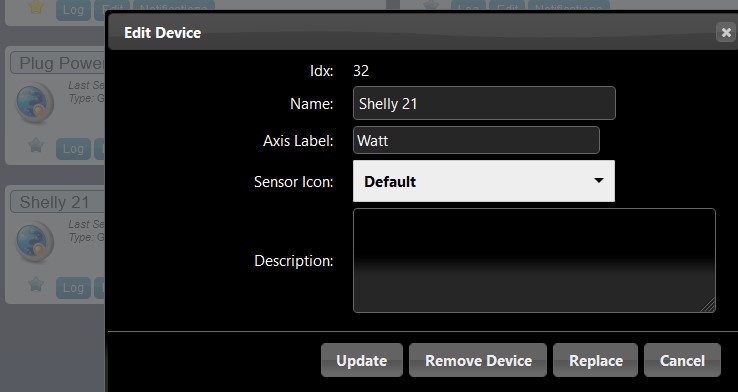

First create a dummy device like this.
In fact on the left you see two devices of this type: Plug Power and Shelly21

HvdW wrote: Thursday 19 January 2023 11:05 Here you go.
Here is my script:

Hoi Walter,
I am using Zigbee2MQTT with plugin v.1.19.1 (zStack12 20201127) and usb Texas_Instruments_TI_CC2531_USB_CDC___0X00124B001CCE0853-if00 -> ../../ttyACM0.
Zigbee has created
513 switch,
512 power,
514 current,
515 volts
Yours sincerely,
Fred

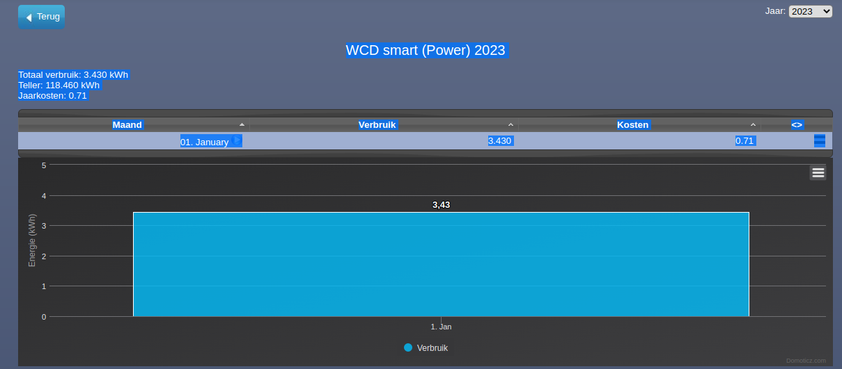

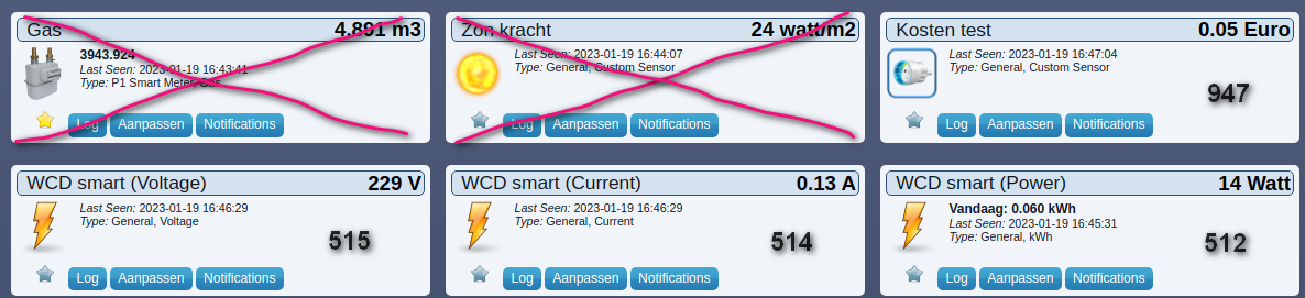

Hi walter,
Glad you want to help me with this.
I took some pictures of the logs and the switches.
Which I hope the script can work the way I want it to.
Unfortunately I can't figure out how to process something like this from the log in a script.
I am now able to make very small adjustments by trying a lot. At Cost test (947) there I would like to see the cost of the measurement

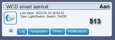

Hi Walter,
This is the switch of the smart plug.
Ik was hem vergeten erbij te plaatsen
WCD 513.png (16.06 KiB) Viewed 2150 times
