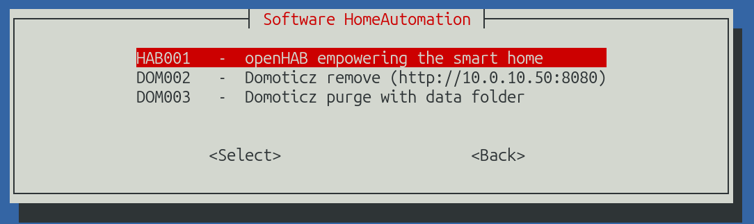

There is another simple way to deploy domoticz on any single board computer (also x86 PC).
All you need to do is this:
armbian-config --cmd DOM001
Requirement: Armbian OS, more about this install.
Sources: https://github.com/armbian/configng
