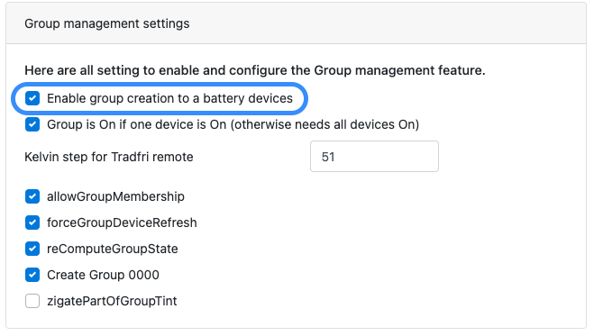

I followed the steps in https://zigbeefordomoticz.github.io/wik ... ller-blind
After enabling this setting the blind will show up in the list, but only the blind. When I try to save it, it won't save and I don't get a group Id.
Is there some other setting I need to enable? I have enabled "Create Group 0000" but it doesn't create and save that group either...

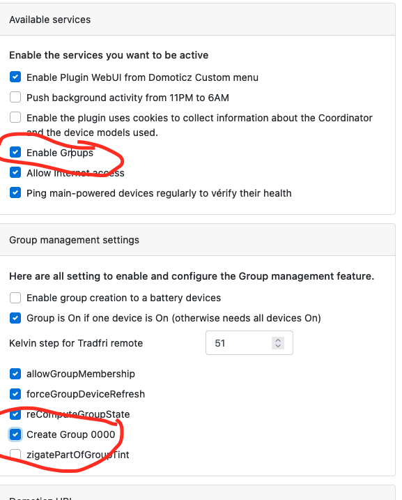

So here is what I did on my test system with a ZIgate V1
1- in the settings enable
- group
- create group 0000
2- I restarted the plugin
and after the restart got the group 0000 created
So if you cannot reach that, please have a look to the Domoticz logs and the Plugin logs, because that would mean something do not work.
- group
- create group 0000

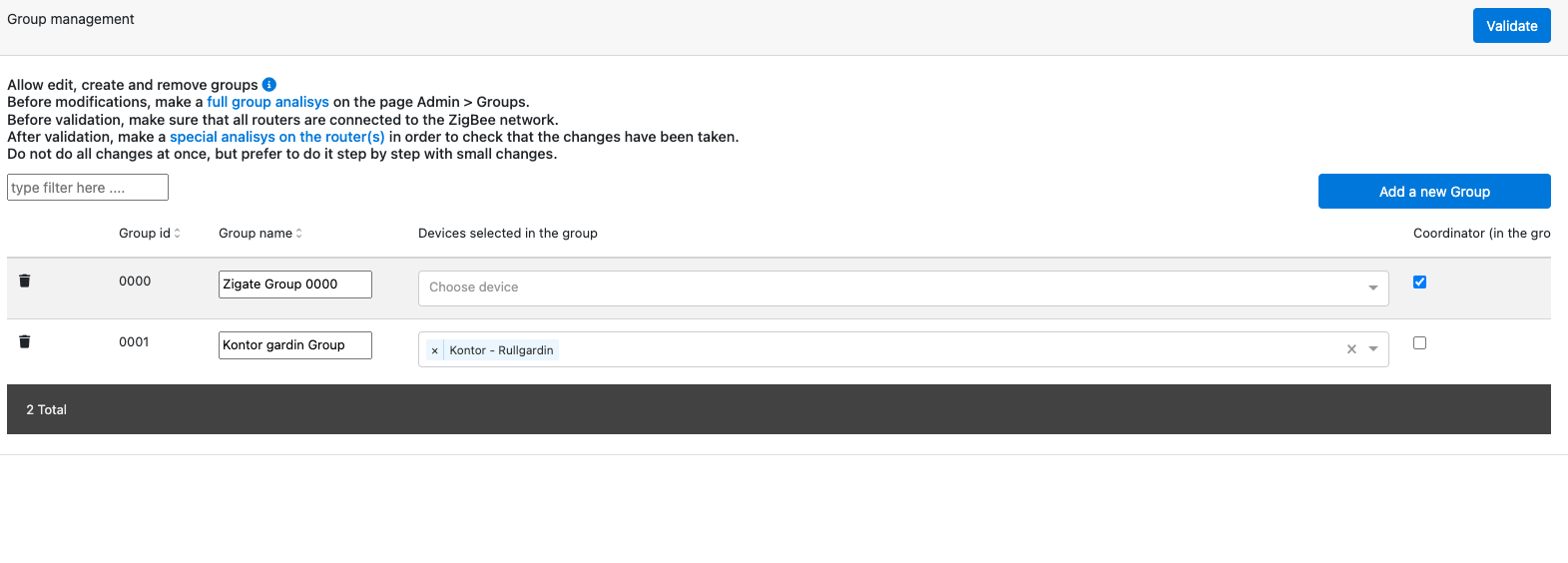

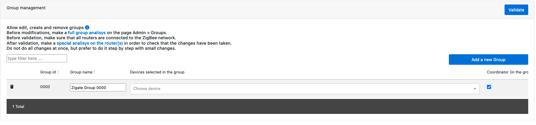

Hey I got it working! (the group that is).
I had to disable and enable the plugin from Domoticz Hardware tab, the plugin restart from the DomoticzZigbee WebUI didn't take apparently.
Thanks for your help!
Now if I could only get the remote joined to the group.
