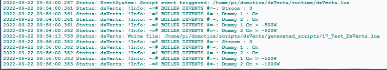

Now I see why it does not work, I read once from someone that negative values are not recognized, I see that now also in the log. Although current Wh is negative by production of solar panels (> 1000W) value stays '0'.
So DzVents neither Blockly will not be able to control a 2-stage boiler or loading an electric car, i.e. only power on my boiler if current power use is negative 1000W or have a 2nd step switching on something when current power is negative 2000W or more...
If someone nows a solution? Thanks for helping Patrick,

you can try a work around by making the negative into a positive value
    local Stroom = dz.devices(97).WhActual * -1

Re: DzVents script turning on dummy switches when power use is negative
Post by Wilpshaar »
Thanks Patrick, I added the '*-1' and will test this weekend (if we see the sun althoug :D ). Now in the log negative values are returned so that is ok. If solar power and negative use we should see positive numbers then.
