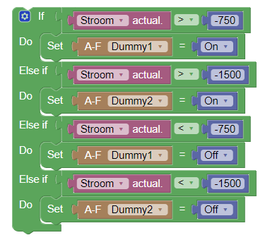

Of course this is used for swithing on a 2-stage boiler. I power it on now telling power is <1 Watt and if solaredge is >1500W. But I want to be able to h
[/img][/img]ave a simple script which can turn of 2 switches when power is -750 and -1500W (as example).
Who could help me out with a DZVents script for turning on dummy switches when power is negative? Seems blockly what I use can't work with negative numbers, don't get it work. Can someone create 2 Dummy switches called 'Dummy1' and 'Dummy2'. Then, if power is negative -750W switch on Dummy 1 and if power is negative -1500W switch on Dummy2. Of course is power becomes lower then -1500W Dummy2 should turn off and if lower then -750W Dummy1 should turn off. Who could help me out!
- blockly example
- blocly.png (22.72 KiB) Viewed 2465 times

Blockly else-if is not really an else-if like you might be used to from other programming languages. Those else-if statements will all just be executed sequentially and tested. When true, the set statement will be executed.
So in the example:
Suppose power is -1000, then
First dummy1 will Not be switched on.
Second dummy2 will be switched on.
Third dummy one will be switched off.
Fourth dummy2 will Not be switched off.
So in the end dummy2 is on.
Is that what you want?
Suppose power is -500, then both dummy1 and dummy2 will be switched on (because > -750 and > -1500)
But if power is +500, then also they will both be switched on.
etc etc
So you need to add a few extra tests with and/or logic.

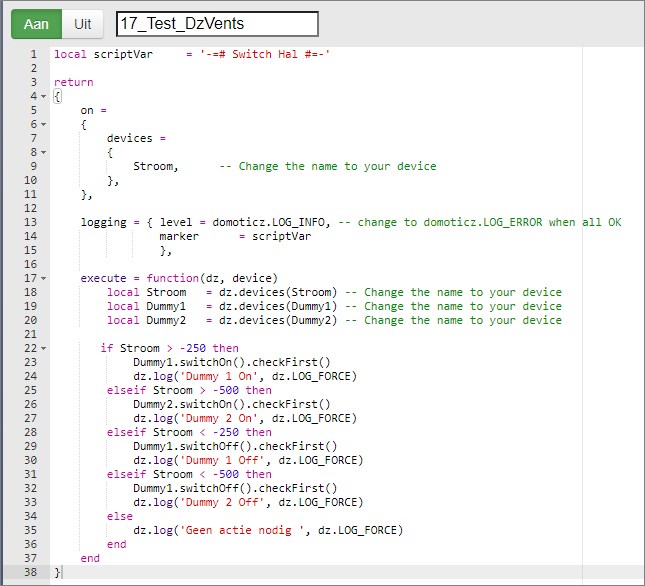

HI PAtrick,
I am afraid nothing is happening? See nothing in the log, see no dummy switches changing, I could test when I remove the '-' (minus)
Thanks in advance, thanks for helping,

Is the script being triggered by the deviceWilpshaar wrote: Tuesday 20 September 2022 13:20 HI PAtrick,
Chamge otherwise the devicename for the IDX number
Please use CODE instead of image for script

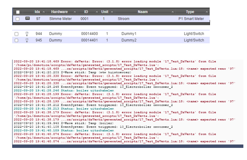

HI Patrick, for testing I use in the evening now of course positive power consumption but we could check working of script. Bit more happening now, have error in log "<name > expected near '97'. Any idea? Thanks!

Here overview of names/IDX and log
- DZ.png (197.23 KiB) Viewed 2396 times

- madpatrick
- Posts: 885
- Joined: Monday 26 December 2016 12:17
- Domoticz version: 2026.1
Re: DzVents script turning on dummy switches when power use is negative
That is of the "elseif" function
Change it to "if"
Try to play with the script.
It is pretty easy and there are enough example or see : https://www.domoticz.com/wiki/DzVents:_ ... _scripting
Change it to "if"

HI Patrick, I think I am doing something wrong again, currently power is over minus 1200W
2022-09-21 10:08:05.841 ...cz/scripts/dzVents/generated_scripts/17_Test_DzVents.lua:39: unexpected symbol near '}'
2022-09-21 10:08:06.017 Error: dzVents: Error: (3.1.8) error loading module '17_Test_DzVents' from file '/home/pi/domoticz/scripts/dzVents/generated_scripts/17_Test_DzVents.lua':
2022-09-21 10:08:06.017 ...cz/scripts/dzVents/generated_scripts/17_Test_DzVents.lua:39: unexpected symbol near '}'
2022-09-21 10:08:15.835 EventSystem: Event triggered: 10_Electroboiler omvormer_1
2022-09-21 10:08:15.836 Status: boiler opwarmen
2022-09-21 10:08:15.784 Error: dzVents: Error: (3.1.8) error loading module '17_Test_DzVents' from file '/home/pi/domoticz/scripts/dzVents/generated_scripts/17_Test_DzVents.lua':
2022-09-21 10:08:15.784 ...cz/scripts/dzVents/generated_scripts/17_Test_DzVents.lua:39: unexpected symbol near '}'
2022-09-21 10:08:25.815 EventSystem: Event triggered: 10_Electroboiler omvormer_1
2022-09-21 10:08:25.816 Status: boiler opwarmen
2022-09-21 10:08:25.774 Error: dzVents: Error: (3.1.8) error loading module '17_Test_DzVents' from file '/home/pi/domoticz/scripts/dzVents/generated_scripts/17_Test_DzVents.lua':

}- madpatrick
- Posts: 885
See my previous post.
You are forgetting END after the IF function
This my log now:
This my log now:
