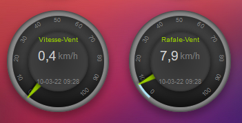

New question!
Is it possible not to display the indications 'NNE and 9.4 and other' but not lastupdate

Doudy wrote: Monday 07 March 2022 9:01 Hello,
New question!
I do not completely understand your question.
You mean, show 28.1 and last update. Hide direction (NNE), and other details?
Can you post your block definition as well?

Yes show only 28.1 and lastupdate and
hide direction and other details
My block :

You can set the values parameter to an empty array to hide the additional data, like this:
blocks['windspeed'] = {
    idx: 39,
    title: 'Wind speed',  // Vitesse vent
    type: 'dial',
    subtype: 'windspeed',
    values:[]
