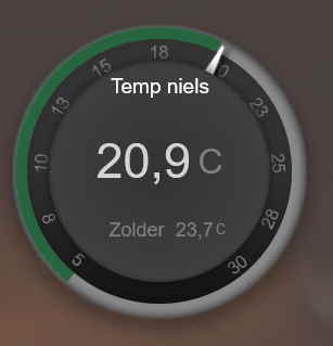

setpoint=xx not working in the configuration below. So colors do not adjust up or below 16 in this case
I inspect the code and data-setpoint is empty, and should be 16
2115 is a setpoint device
2125 is the measured temp of the device
2242 is a rfxcom device
blocks['mytherm'] = {
        idx: 2115,
	showvalue:false,
        title: 'Temp niels',
        type: 'dial',
        width: 4,
        color: 'white',
	setpoint: 16, 			// werkt niet, kleur veranderd niet
	//isSetpoint: true,
	flash: true,
	showring: true,
        showunit: true,
        shownumbers: true,
        last_update: false,
        min: 5,
        max: 30,
        values : [
                        value: 'Temp',
                        idx: 2125,
			//label: 'Radiator ',
			unit: 'C',
                        decimals: 1,
			addClass:'nielstemp',
                        value: 'Temp',
                        idx: 2242,
			label: 'Zolder ',
			unit: 'C',
                        decimals: 1,
			addClass:'nielstemp2',
css
dial .bar.primary,.dial .fill.primary {border-color: #25663E;}
.dial .bar.secondary, .dial .fill.secondary {border-color: #E41C0C;}
.nielstemp  {white-space: pre;font-size: 30px!important;color: lightgrey;}
.nielstemp2 {white-space: pre;font-size: 12px!important;color: grey;}

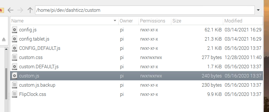

I migrated my Domoticz/Dashticz environment Friday March 12th. I believe I installed Dashticz 3.7.4. My dashboard was working flawlessly. Last week I did not update the software.
Today I was forced to re-install my Pi and subsequently installed 3.7.6. When I restored my config.js the resulting screen was missing all modifications I had made but did show all devices configured in my config.js. So in effect all devices are shown on one page and the background does not show. I have checked the IP in my config.js (you never know ;) ) and it was configured correctly. Checked if the background image was available (bg9) and it was. I also checked these in the second config.tablet.js that I use as an alternative dash for my tablet. No problems there either.
The buttons are working though :?
Has there been a change since 3.7.4 I am not aware of? If so, how can I fix the problem?
Any help greatly appreciated!
TIA

Press F12 in Chrome to open DevTools. Refresh Dashticz. Which errors are reported on the DevTools console tab?
Sjonnie2017
Posts: 377
Joined: Wednesday 02 August 2017 19:43
Domoticz version: Latest ß
Re: Dashticz v3.7.6 beta
Post by Sjonnie2017 »
Hi lokonli,
Thanks for your reply. I get this error:
This page uses the non standard property “zoom”. Consider using calc() in the relevant property values, or using “transform” along with “transform-origin: 0 0”. 192.168.16.165:8082
XHRHEADhttp://192.168.16.165:8082/custom/custom.js?v=1616258419696
[HTTP/1.1 404 Not Found 1ms]
No custom.js file in folder custom. Skipping. js/main.js:183:21
XML Parsing Error: undefined entity
Location: http://192.168.16.165:8082/tpl/debug.tpl?14
Line Number 7, Column 38: debug.tpl:7:38
XHRGEThttp://192.168.16.165:8082/custom/custom.css?v=1616258419696
[HTTP/1.1 404 Not Found 2ms]
No valid custom css file: custom/custom.css. Skipping. js/main.js:348:15
Setting up websocket js/domoticz-api.js:122:17
[open] Connection established js/domoticz-api.js:180:15
Synchronous XMLHttpRequest on the main thread is deprecated because of its detrimental effects to the end user’s experience. For more help http://xhr.spec.whatwg.org/
I thought I'd rename CONFIG.js to config.js but that didn't make a difference :|
Looking forward to your reply!
Greetz,
Sjonnie
YouLess Energy meter
Lokonli
Posts: 2296
Post by Lokonli »
Dashticz can't read custom.css and custom.js
Are the files still in the custom folder?
If they are, check that access rights are correct for these files: root must have read access.
Sjonnie2017
Posts: 377
Thanks for your reply and support!
I checked the files and they are readable and writable to any
Anything else I can try?
TIA
Greetz,
Sjonnie
EdwinK
Posts: 1820
Location: Rhoon
Post by EdwinK »
Shouldn't it be CONFIG.js instead of config.js?
